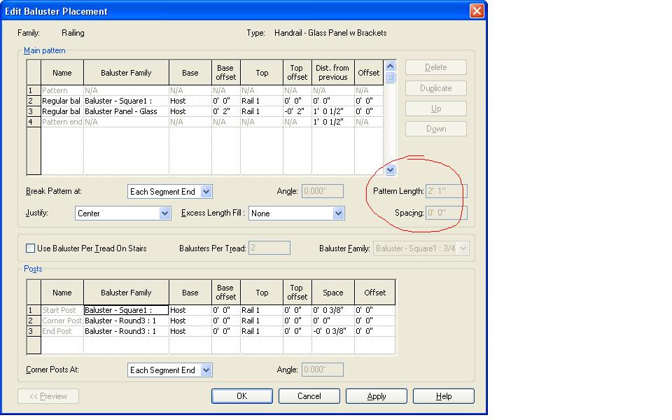

I have used the standard railing style from Autodesk to create a similar railing style that I need for my project; however, I cannot adjust the length of the glass panels.
The glass baluster panels were set up at 24" in length. I opened the family and created an additional 5'-0" panel. I loaded this into my project, but now the panels overlap, and there appears to be no way to respace the panel length (see attached dialog). If I could adjust this, I could get my railing to look correct.
Anyone have any ideas. I must be missing something here.

It look like its the "distance from previous" and "offset" that are wrong. distance from previous should be half the distance of the  glass panel. this should get you pointing in the right dirrection.

Thanks! That is what I was looking for. I knew it would be something simple, but I just kept overlooking it. Thanks again for your help.
