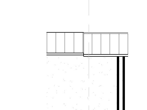

it's driving me crazy.  the roof is all one piece.  it's a sloped roof.  but for some reason part of the roof decided to move itself 3.5" lower than the other part but when i try and select it it's still one piece of roof!  argh!  why?  how do i fix it!??!
Thu, Oct 4, 2007 at 7:05:18 AM | roof problems! help!
Not near enough info here!  I assume this is an elevation but not sure.  If that's the case then the vertical lines must represent the face of the roof and a roof doesn't split into two components so you have two seperate roofs.  Delete one and see if the both disappear.
Thu, Oct 4, 2007 at 10:52:49 AM | roof problems! help!
archshanna
Joined: Wed, Jun 6, 2007
19 Posts
Yes that picture was of an elevation, the dark lines on the right are a wall.  The horizontal lines are the edges of the roof, and it's sloped towards you, so you see the vertical metal seams on the roof.  I can't just delete the roof and redraw it because so many things are attached to the roof it would screw everything up.
Thu, Oct 4, 2007 at 11:03:40 AM | roof problems! help!
The suggest was to delete one side or the other of what we see in this elevation and see what happens.  You can always UNDO the deletion.  There has to be two roofs here or you have a jog in your roof plan .... which you haven't shared.

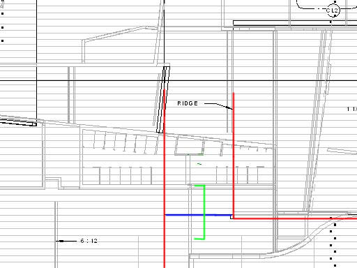

Thu, Oct 4, 2007 at 12:16:18 PM | roof problems! help!
archshanna
19 Posts
there's a jog in the roof.  the red is the edge of the roof.  the blue is where that weird problem is, and the green is where that section was taken.
Thu, Oct 4, 2007 at 12:16:48 PM | roof problems! help!
archshanna
19 Posts
oh and that image is a piece of the roof plan

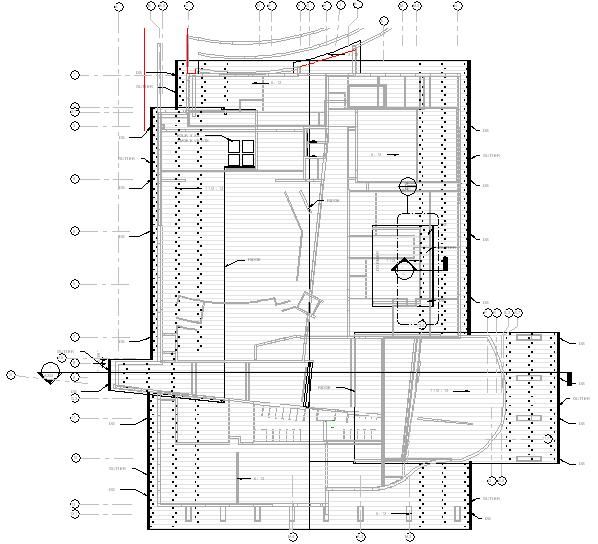

Thu, Oct 4, 2007 at 12:24:32 PM | roof problems! help!
That sure isn't much help....
Thu, Oct 4, 2007 at 12:36:11 PM | roof problems! help!
archshanna
19 Posts
do you want the whole roof plan?

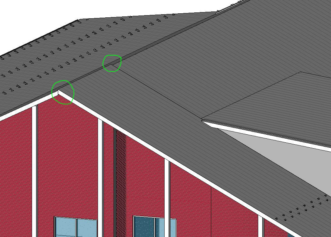

Fri, Oct 5, 2007 at 3:55:49 PM | roof problems! help!
#9
archshanna
19 Posts
3d image...  still can't fix this stupid roof...
Fri, Oct 5, 2007 at 8:33:00 PM | roof problems! help!
#10
robinballew
robinballew Avatar
Joined: Sun, Nov 27, 2005
298 Posts
3 Stars: 4 Votes
I would check the edges that define the slope. I would guess that when you made the roof you on some edges you pick the wall as the defining point and others you just added a line. If you remove the line on both sides and redraw them in a consistent manor it should work.
