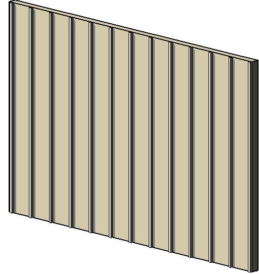

Would any of these techniques work to produce a standard spacing of vertical reveals? For example, to add "vertical board & batten siding" at 16" on center (assuming that i don't want to use a surface pattern, because I want the shadow lines of the raised battens to show)

What I do for vertical battens is place a curtain wall in front of my main exterior wall. Define a fixed spacing of 16", add mullions to only the vertical grids of the proper size and material, change the curtain panels to blank, and align and lock the curtain wall to the exterior wall. See attached image. Tom

Nice technique, tomdinmn... thanks! Now, I just need to try it on a battered wall. I wonder if you can get the battens to follow a vertical slope...
