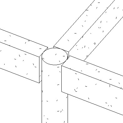

Hi everybody! I don\'t know how to join the structural beams with the structural columns. I don\'t know if it can be done or if the structural elements are just representation and never actually meet. Thank you I purged the rvt file, but I still get this size. Is this normal? I guess it's the same thing on the post http://www.revitcity.com/forums.php?action=viewthread&thread_id=742 Post edited on 2005-02-08 01:43:20

The structural elements will never actually meet and do this due to the fact there would most likely be a plate that holds everything together. I suggest changing the beams to a different family category, say generic models, so they lose there structural rules and you have a little better control. HTH.
