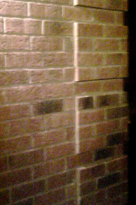

I've been using Revit for plant layouts and Architecture.  I use Revit, Arch., MEP and Struct 2008.  I'm creating my house in Revit, I tried to create the reveal showed in the attached image with no success.  Has anyone here ever done these?

I spoke with an Architect at the Autodesk Experience the Possibilities Tour in Atlanta yesterday.  I found out that the correct term for what I named "reveal" is actually coining.  He gave me some tips and I will try to create it and post an image soon.

you can find some pre-built quoin families Cryingnot "coin"Winking in the RevitCity download

Thanks Dude.....much appreciated, I'll check it out but,  I would still like to know how to create one.

just reverse engineer a downloaded one to get a handle on how to start
