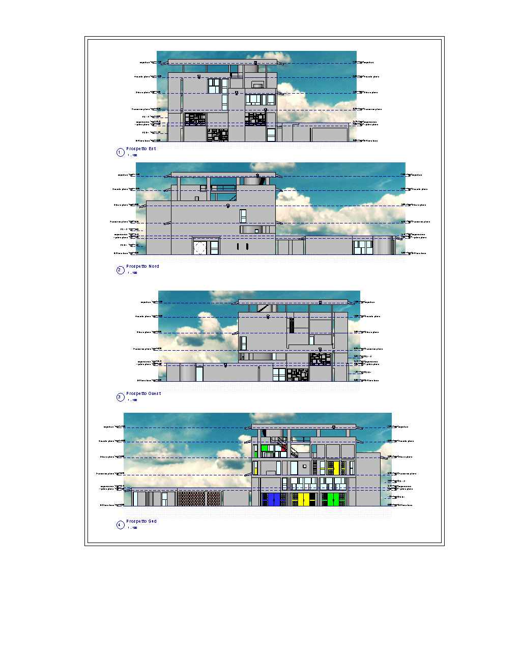

Is there a way to get an image (exterior building sign) to show up on a non rendered view?

Hi, try File/Import-Link/Image you can control the order of visualization of the image behind or not the model. The sky image in the background is imported in every elevation view, I think it's nice.
Hope this help you a little bit.

sorry too large the pdf i was attaching in the last post

That worked.  Thanks
