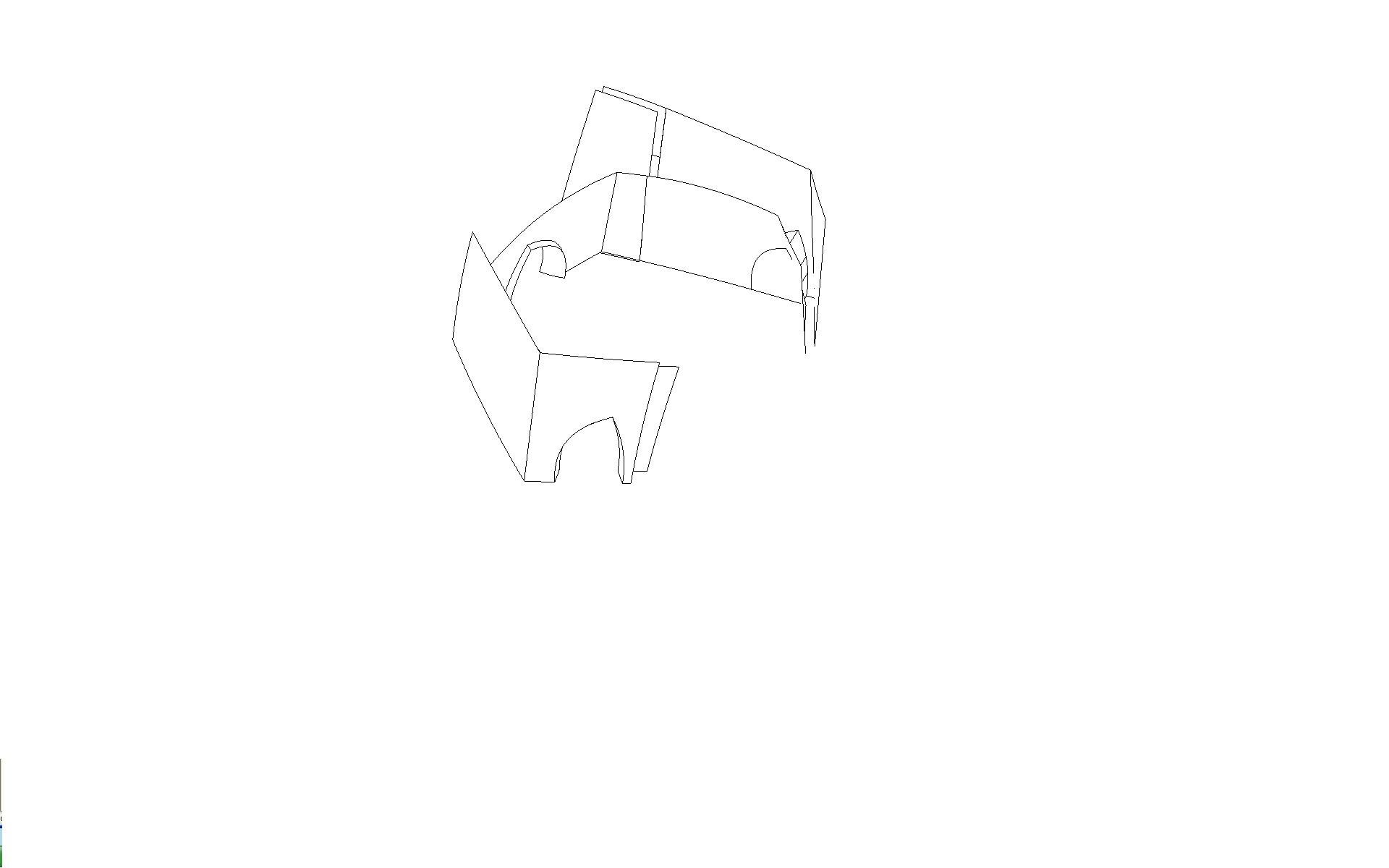

Hi, thank you for uploading the .sat file, actually I'm using RB9 and I can't open the .rvt file, so what I did is to link the .sat file and create an in place wall family with the union solid tool, importing again the .sat family durign the skecth mode for the base and for the top (in total i've impored 3 times). Then I've setted the height of the extrusion to an auxiliar level and that's the result.
For the openings follow the same prodeure using the extrusion void tool.
Creating wall by surface was not a good idea because in this case you have a complex surface with 3 degrees of freedom:the length, the height and even the thickness, this parameters can vary indipendently one from each other, but you're lucky because you have the "limits" of wall, the surfaces you drawn in Rhino.
When you create a wall from surface you're asking to Revit to draw a wall with a specific thickness (that you can edit in the properties of the wall family) that belong to a surface. Like I said, in this case you have to create a 3D wall with irregular thickness, instead.
So what I can suggest to you is to try to bring out a few 2D plan views of the chapel from Rhino, like slicing a terrain to a fixed distance, and then use this 2D views to set an appropriate base and top union solid wall (the top of the 1st slice would be the base for the 2nd, and so on).
Hope this help you to do things quickly and without loosing the accuracy you need.
-paolo
