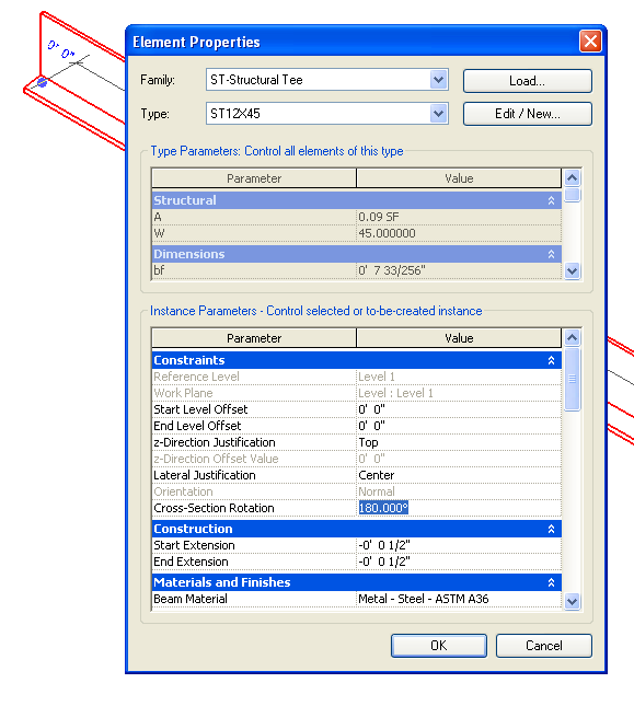

I am doing a balcony w/ a steel structure of angles and WT's.  I need the WT's to be the T down and it will only let me put in in a structural T up mode.  Same issue w/ some angles, where I can't rotate the angle properly.  Is there a trick I am missing to use these or do I have to create my own profiles so I can rotate them as I need them?

When in doubt check element properties
