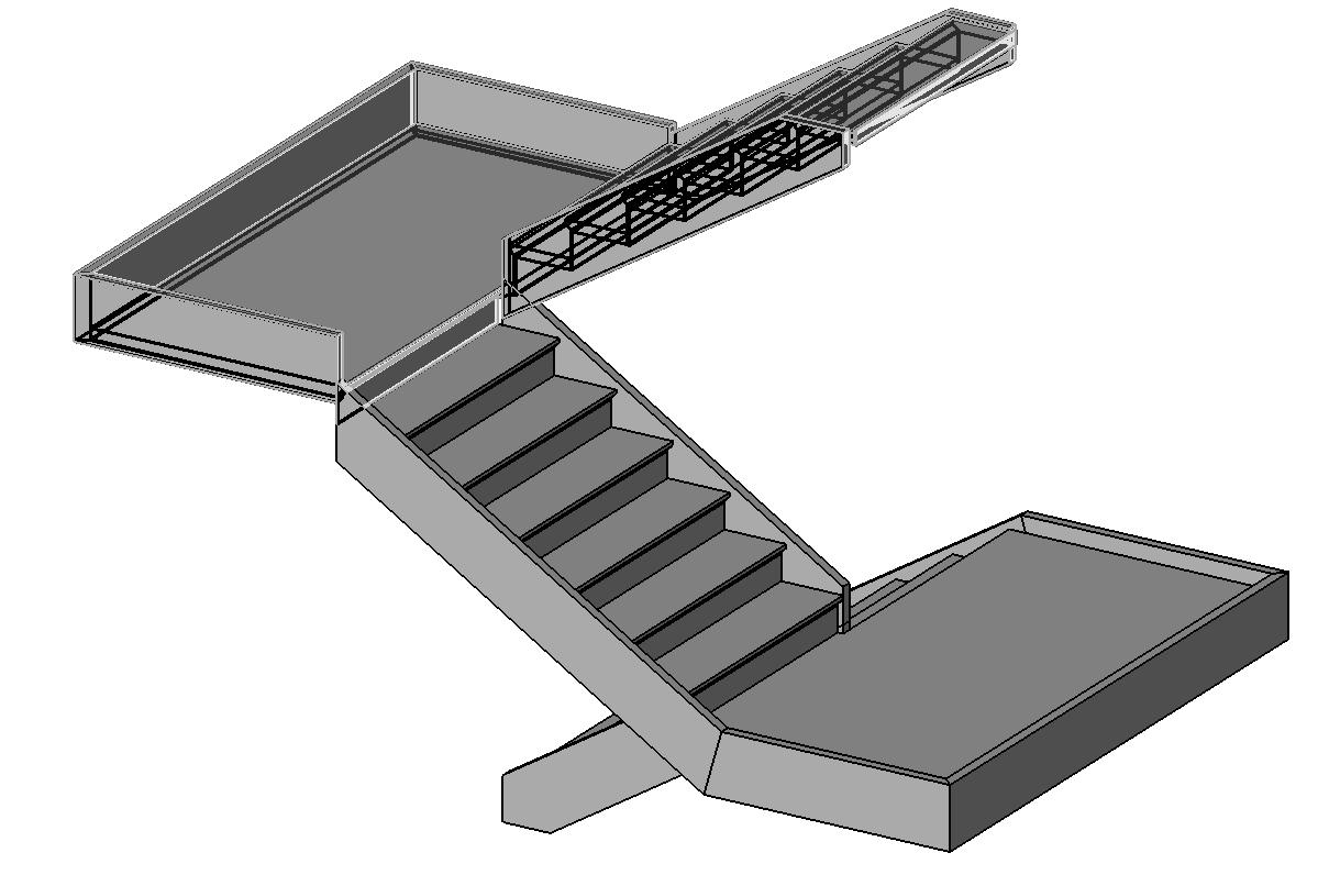

I was just wondering if there was any way to make the sides of the top landing match up with the bottom stairs? The picture below shows what I have so far. Any help or advice would be greatly appreciated! Thank you!

justinblack
Joined: Fri, Jun 22, 2007
62 Posts
5 Stars: 1 Votes
I believe the answer you're looking for is in this blog post.
http://revitoped.blogspot.com/2006/04/flat-slope.html
Let me know if this isn's what you're looking for.
JB
