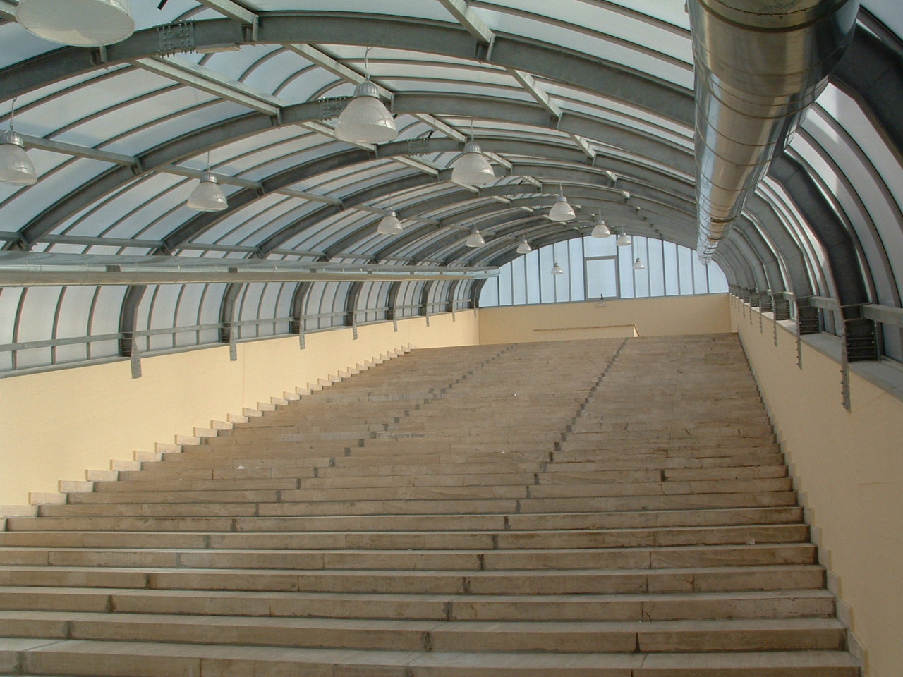

how i can create a roofing like this in the photo? it is possible with revit?how?or i have to use another software like autocad or 3dsmax?thankx

Providing your using version 7.0 its relatively easy. You would need to create a mcurseextrusion to the shape of the arch then apply a curtain system to the arch and turn off the mcurse You can then apply the appropriate mullions to the grid edges to represent the beams etc... Check out the tutorials on the new revit 7.0 features. HTH.

thanx!!!
