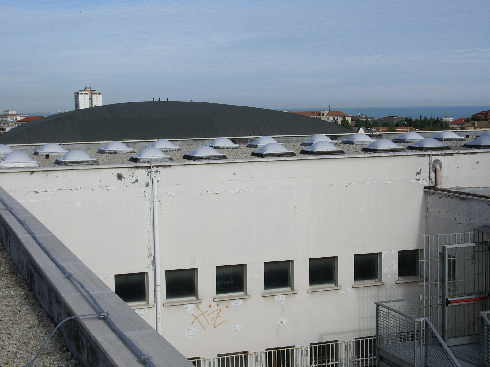

excuse me. how i can do a skylights like the skylights in the photo in revit? thanks

You would need to create a roof hosted generic model family with an opening, then go to settings-->family category and parameters-->and change the family to a window. It will then behave and tag as a window. Its just a matter of modelling how you'd like to show it. It would also depend on whether you use a roof for the roof deck or a floor... HTH.

could you elaborate a bit on how to create the curved roof after creating an opening from the generic roof based family template and changing it to window in the settings>family category and parameters commands, how do you then model the curved skylite

I'd create a solid revolve to get the curved profile then use a void to cut the element back to a square. If i get a spare second i'll post an example. HTH.
