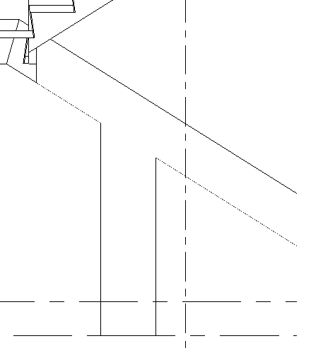

Is it possible to attach the top of a wall to the underside of a stair stringer (i.e. the stair stringer is resting on the wall, therefore, the top of the wall slopes with the stair)??

Draw a section along one side of the stairs. Go to the section. Draw a reference plane on the same angle as the stringer. Click the wall and attach top to the reference plane.

This tip is good, but how I can clean the joint between the stair and wall, like clean geometry; wall and floor?

use the linework tool to make the line at the top of the wall invisible!
