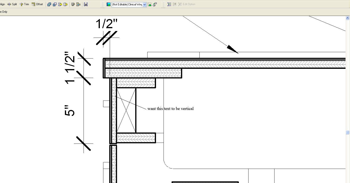

trying to insert a plywood detail component, but the pattern remains horizontal. any ideas about making the fill pattern orient with the detail component, horizontal, vertical, or otherwise?

Click on settings>fill patterns>find the pattern you are using, click edit, you will see a pulldown set that to align with element.

i tried that and the plywood pattern still was verticle.....

still not having any luck...anyone know what i seem to be doing wrong? here is a screen shot of what i am talking about. the plywood patterns are filled regions

Are you not using the plywood detail component?  If you are just drawing filled regions I don't think those know which way is up, you need to make a detail component(or use the plywood that comes with revit).

i imported the plywood detail component but the pattern won't orient properly when the plywood is vertical.

here is another sample of the problem that i am having. i want the plywood pattern to orient correctly. but am having no luck. anyone have some idea about what to do?

I should add that the plywood pattern is part of a detail component that was found in the Revit library

Have you solved this problem yet? I have exact the same problem. I changed the orientation for the fill pattern but the pattern still has the same orientation on paper.
If you have the solution please tell me.

Try to use a model fill region instead of a drafting fill region.

annateo31- This post is 4 years old. Have you tried your suggested process yourself in a detail component?
