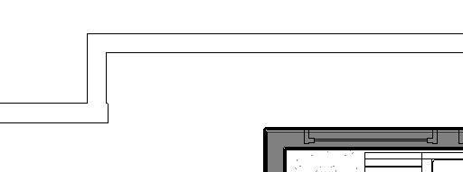

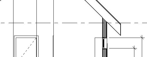

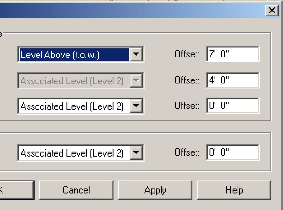

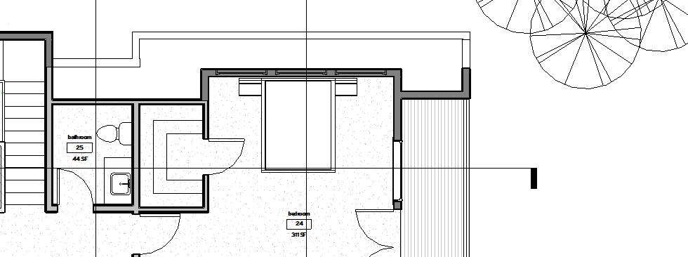

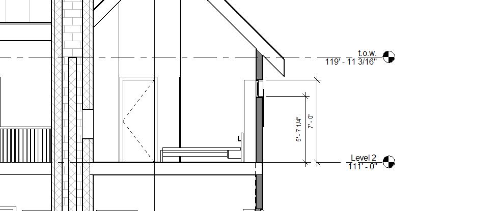

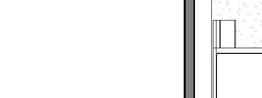

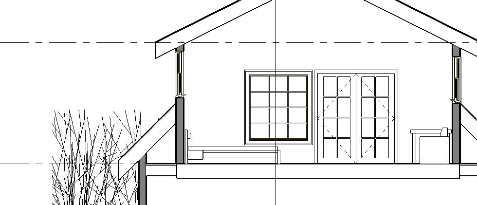

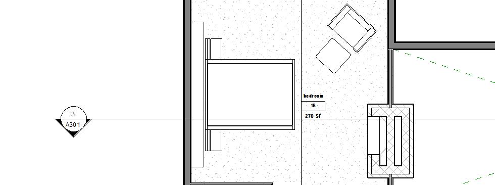

While the plan region worked fine, I came across this as I continued working. See attached files.
Here are two different windows, both above the cut plane. One window shows in the plan, while the other does not. I've attached the plan views and the section views as well as my view range settings. Can anyone explain? I would prefer the windows above the cut plane to show as they do in the view that you can see them, as opposed to making a view region.

Here are better images...
26562_windo_above_cut_1_sect.jpg26562_windo_above_cut_1.jpg26562_windo_above_cut_2_sect.jpg26562_windo_above_cut_2.jpg
