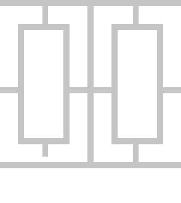

howdoes you go about creating complex railings  see attachment

The handrail extensions are simple.  Just download the extensions on this site and modify them.  The brackets are also on this site.  Both replace a post in your handrail.

thanks WWhub for your quick reply. but if you want to create yours own what template do you use to start with and is ther any tutorials there that can use for help

Use the Balustrade Post template.
Check the in-built tutorials...

Hey, are you able to create rails that look like my picture? If so, how?
