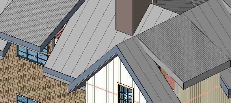

Another rookie question...What is the best way to create dormer rake edge walls? See attached image for reference. As you can see the change in roof pitch creates the triangular areas that don't have  walls, but there is not a wall in the room below. Does anyone have a good way to fix this?
Thanks.

Make a wall, attach the top to the upper roof, then in elevation edit the profile of the base to match the slope of the lower roof.
