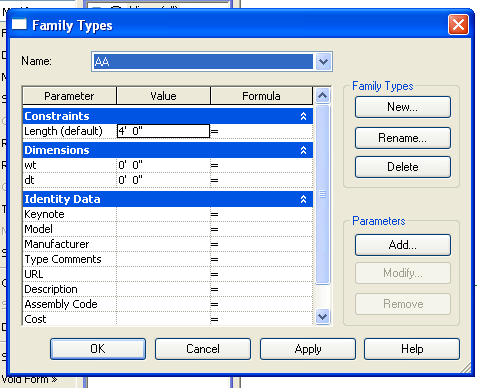

HiCreated a profile. Placed dimensions and created parameters.Created a family. Placed a sweep. Created a catalog. Attached the profile. Profile reads catalog but when I try to adjust parameters nothing happens. I know it is possible because if I open C-Channel.rfa I can adjust parameters. Spent all weekend trying to get it to work. Any help will be appreciated.bob v

No error inserting family.

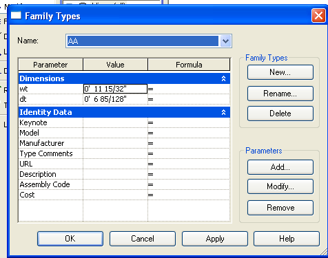

Picture 1 shows profile. 2 is family
3 dialog of family. Notice after profile is inserted parameters are not read from profile.

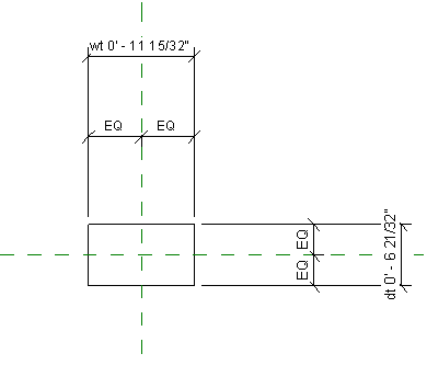

4 is profile dialog

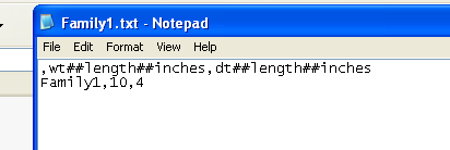

5 is catalog.

 Rather than attatching a text catalog (even though they are so much faster), try making your catalog by using the generic interface of Family Types in the Family window.  You should be able to make a profile with the constraints you want in the family types dialog box.  then you should be able to load that constrained profile into the family where you can continue to incorporate it into a more complex family.  I'm honestly not sure why your text catalog is not working, but I know that you should be able to do it using the stock interface.
