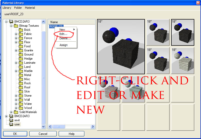

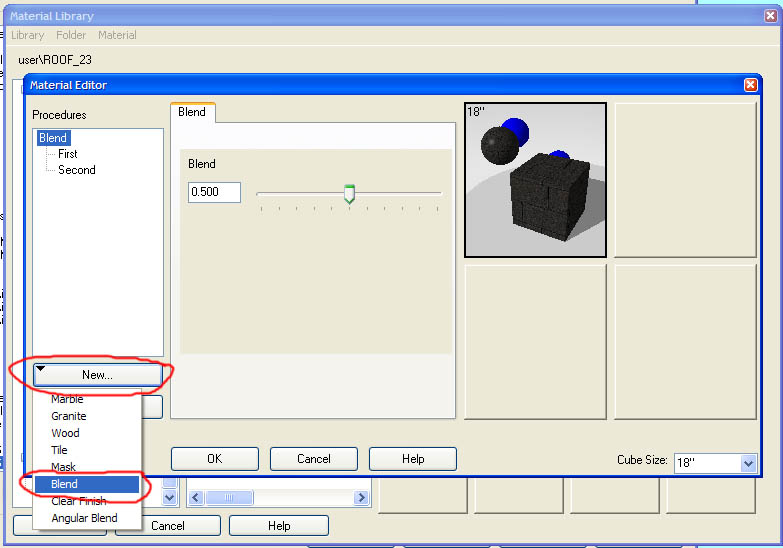

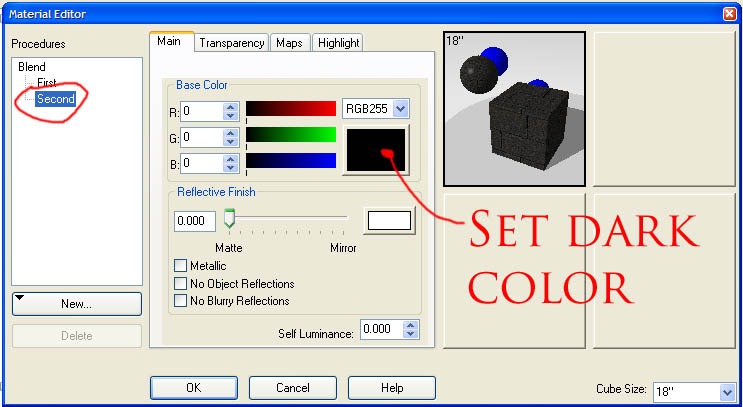

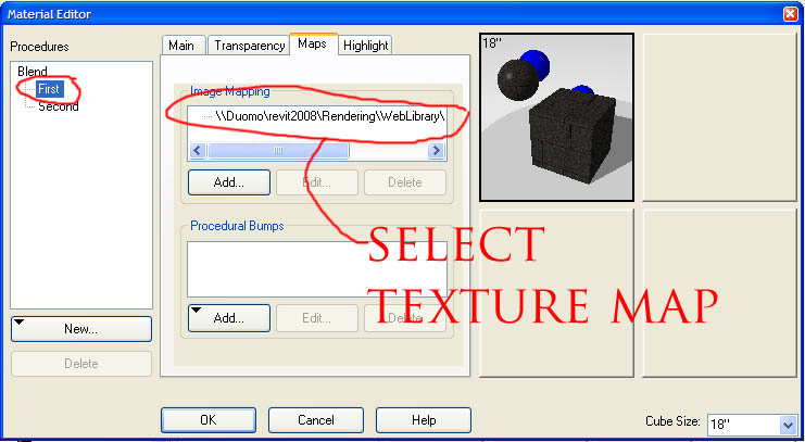

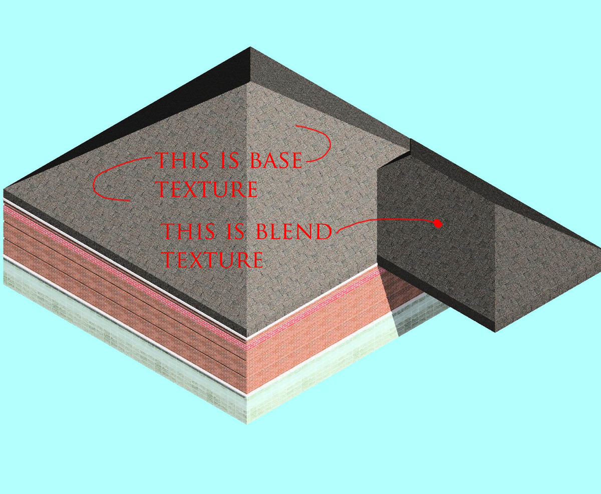

Fri, Feb 1, 2008 at 1:52:30 PM | Rendering Problems
#11
mthurnauer
Joined: Mon, Dec 17, 2007
83 Posts
3 Stars: 2 Votes
Regarding the question about how to make the roofing darker.
The rendering engine in Revit is a little lacking compared to some other applications.  I did a little experimenting and found a solution.
To edit the texture settings, right-click the texture and select edit (See attachment 1). If you are using a texture map based texture for the roofing, use a ‘blend’ texture instead of just a ‘base’ texture (See Attachment 2).  With the blend, you will see in the column on the left that there is an option to adjust the settings for the First material and Second Material. For the first material, use the image map of the roofing (See attachment 3).  For the second material, you don’t need an image map, simply set the color to black.  You can then adjust how dark the material renders by going back to the blend settings and adjusting the % mix of the two. See Attachment test Revit Rendering.
