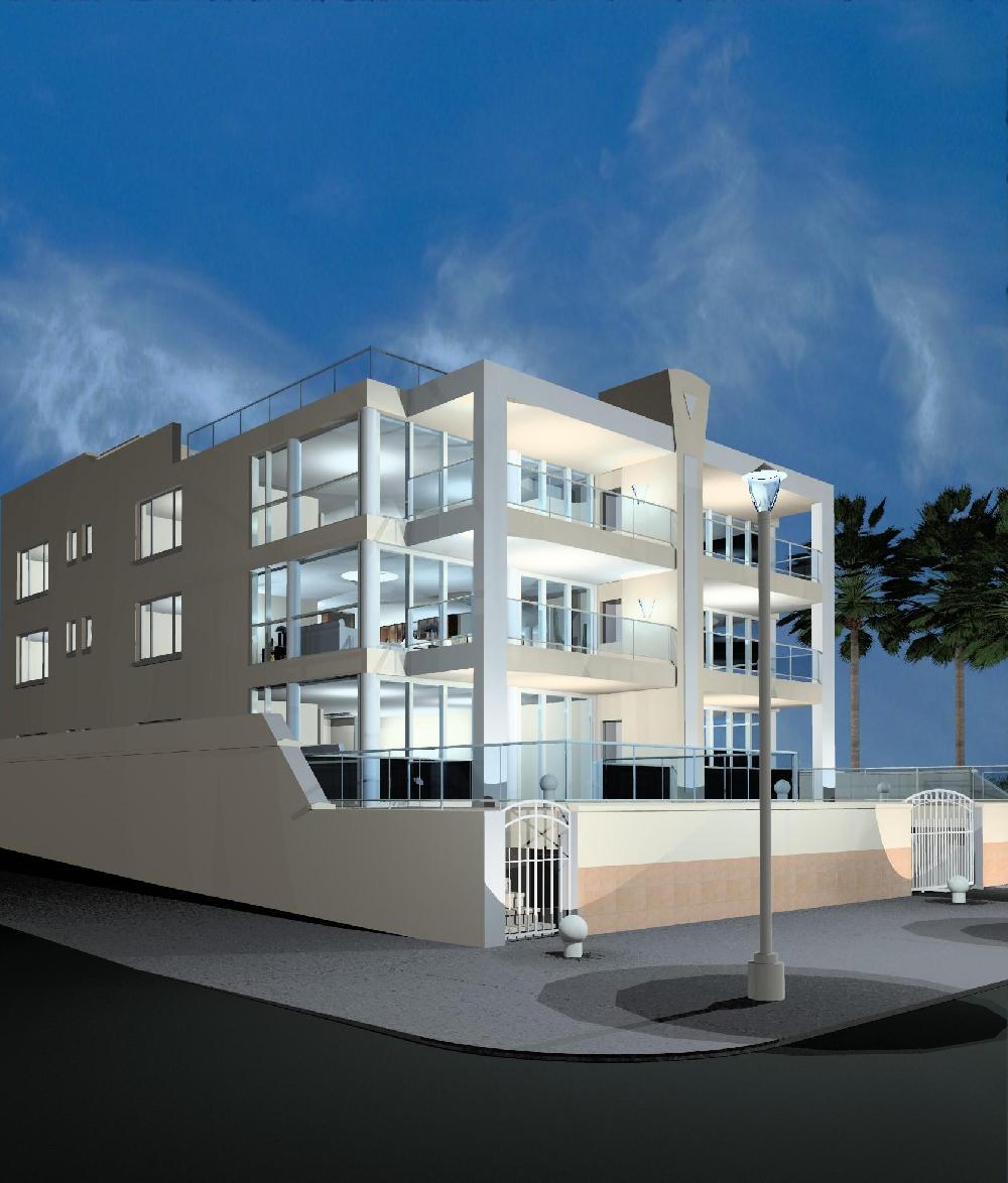

Hi there. Again! Yes, its me, that berlino bed guy back with more questions to you all Puh Well, I've been learning Revit as much as I can because I decided to start to use it on my college work. My problem is the following: I'm making a street with a slight inclination and I want to make a road (this one I know) and on either side of the road a slightly more elevated sidewalk. So you\\\'ve got the road and on either side a sidewalk that\\\'s something like 8cm more elevated than the road level. Is this possible? I took the liberty to take an image from the gallery with what I want (and I still dont know how to make...) Post edited on 2005-01-20 15:15:05
Thu, Jan 20, 2005 at 5:03:56 PM | RE: Elevated sidewalk
Mr Spot
Mr Spot Avatar
Joined: Mon, Jan 12, 2004
2889 Posts
4.5 Stars: 93 Votes
Both floors and topography can have there elevation manipulated very easily. If you are using a floor for the sidewalk, (which was probably the case in the example) its just been elevated above the road by giving it an offset from the ref. level. If you are using topography for both elements, due to the sloping factor. Simply split your topography for the segment that's different and you can move it up and down in elevation to the appropriate level... HTH.

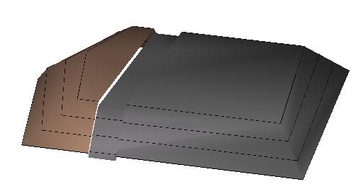

I think I'm beginning to understand. I'm adding a 3D image of what I've done. I think this is where you're heading me to... If so, I've just have one final question. How do I cover up those white spaces between the ground splits?
Thu, Jan 20, 2005 at 9:06:10 PM | RE: Elevated sidewalk
Mr Spot
Mr Spot Avatar
2889 Posts
4.5 Stars: 93 Votes
ahh a picture really helps... Yeah that's what i was saying about doing the kerbs. If you draw a reference plane on the edge of the street in plan and create a section parallel to this. Then set the reference plane as the work plane and go to your new section. Then create an in-place family sweep by sketching the path of the sweep to match the street. Then draw or load the appropriate kerb profile and finish the sketch. Do the same for the other side. And there you go.
