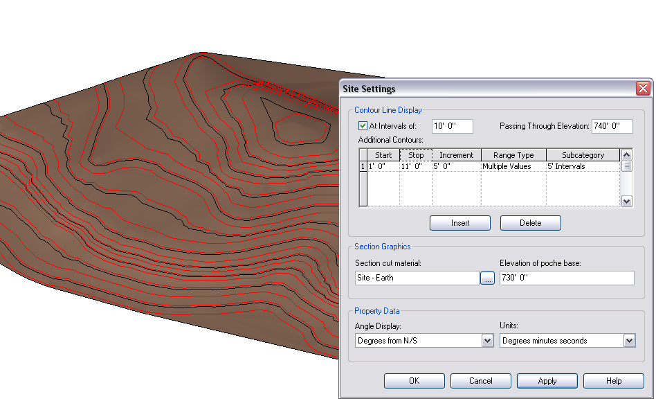

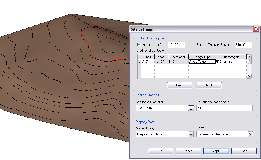

I am having a strange problem with additional contour lines.  It seems that I can place individual additional contour lines and have them appear in the correct vertical location, but if I change from "Single Value" to "Multiple Value" I get additional contours at the interval I specify that pay no attention whatsoever to the Start and Stop fields.  This is in the latest version of RA 2008 (Revit Architecture 2008 - 20070810_1700).
I have attached two pics that show the settings dialogs for each case overlaid on the topography.  The idea is that I would like to see topo lines at 5' intervals on the lower portion of the site, where we will not be building much, and 2' intervals on the upper portion, but right now, I get both of them throughout the entire vertical range of the site.  The intervals I am trying to model are approximately what I will get from the survey engineer when he completes his work.  This topography was generated by eye in AutoCAD from USGS maps at 20' intervals, so it is not terribly accurate, merely informative.
Refer to the Start and Stop definitions from Mr Spot in this thread, which echo the extent of the help for these items anywhere in the Revit Help system.
