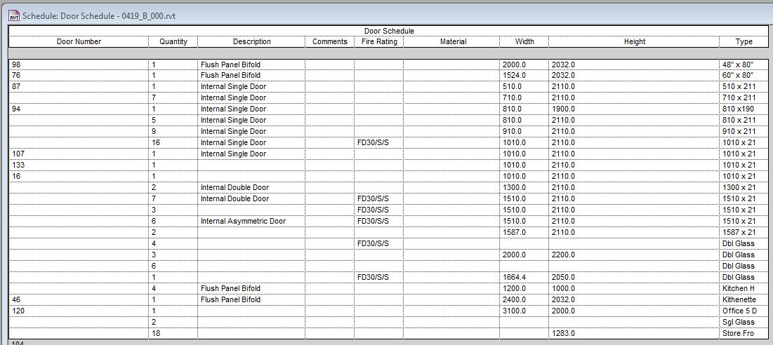

Thought I'd bump this thread instead of starting my own becuase part of it has helped me. I'm trying to set up a Door Schedule grouping matching doors together.
So far I have managed it but Grouping them by type now means that the Door number column (Mark) is left blank, what can I do to get this column to list the multiple door numbers?
For example for the 6x Internal Asymetric Doors, I want the door number column to list 01,05,07,09 etc
Curreny schedule attached
Many Thanks
Simon
Tue, Aug 14, 2012 at 9:09:01 AM | Schedules. How do I avoid having a schedule row for every door, room & window?
The grouping is not your probelem.  If you don't have checked "itimize every instance", then if you have two doors with different values for any field, then that filed will show blank.  After all, which of the multiple data would you want to show?
Check the itimize every instance and you will see the problem.
Tue, Aug 14, 2012 at 9:28:51 AM | Schedules. How do I avoid having a schedule row for every door, room & window?
MEBDesign
Joined: Thu, Jun 9, 2011
45 Posts
WWHub, thank's for your reply. Sorry but I'm not sure I follow. Checking itemize lists every single door seperately which is fine if that is what you want. Where you have the same door used multiple times the only difference in revit is their door number(Mark)?
Is it possible to list multiple door numbers for the same door typres?
Sorry this is my first time with schedules and so don't fully understand the workings of them but also haven't managed to find anything else explaining how to go about this.
Thanks again
Simon
Tue, Aug 14, 2012 at 10:20:07 AM | Schedules. How do I avoid having a schedule row for every door, room & window?
#9
You can't have it both ways.  If you don't want to list every instance then don't sort by just a parameter that will mix data.  Add a second sort by the mark field.
Wed, Aug 15, 2012 at 3:36:05 AM | Schedules. How do I avoid having a schedule row for every door, room & window?
#10
MEBDesign
45 Posts
WWHUB - Thanks for your help. Unfortuinately I am not any closer with this, If as you say I add another sort field - 'Mark' as you suggest then I go back to a table where pretty much every door is listed seperately. So currently I have the 1st sort of 'Type' which produces the list closer to what I want where similar doors are grouped together.
I guess the question is, is it possible to do what I want? the table as attached with mutliple door numbers in the door number column?
Sorry to keep asking on this. If you know of a good guide I could alternatively look at that would be good, can't find any myself
Wed, Aug 15, 2012 at 7:24:44 AM | Schedules. How do I avoid having a schedule row for every door, room & window?
#11
I think you need to spend some time with Revit tutorials on scheduling.  If you want multiple door numbers in one cell of the schedule - you can't get anything like that.  If you want to see each door number then that will be one line of data per door number.
Remember, Revit allows multiple doors to have the same tag.  In our hotels, all guestroom entrances are door number 1.  They all schedule on the same line in our schedule.
