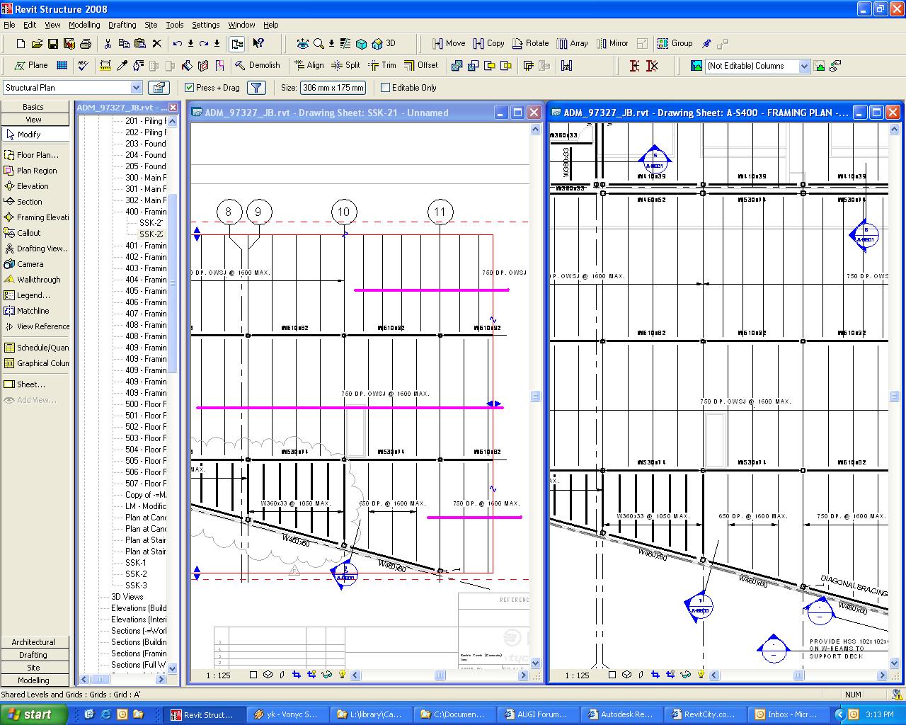

Here's a screen capture of the problem.  Let me explain what I was trying to do.  I have a plan showing the layout of joists.  I've then taken a dimension with tiny text (cause you can't override dim text) and shown the span of the joists.  Then with text, I've written the type of joists and the spacing.  eg: 750 DP OWSJ @ 1200 MAX.  The dimension line is very long because all the joists are the same along that line.  But if I crop across that line it disappears.  This is really for an Addendum which is supposed to be snapshot of the actual drawing so that is why I'm concerned.  Thanks for your help, I appreciate it! JB

maybe I don't quite know what your talking about but try going into view properties and uncheck text crop about half way down. It got me for a while.
 Hope this helps
