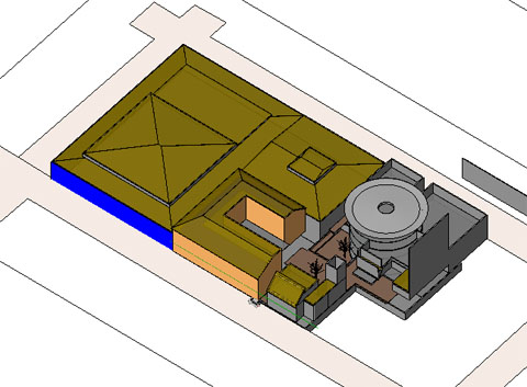

You can have a look on the block I am trying to design.

Well, I can't finish it off. I'm a very small designer, never been into big comercial buildings, so I can't help you there. And kinda the same with groups. I have found a way that works for me, but it probably isn't the most efficient way. I taught myself Revit and I skipped over some things hehe.
I seem to feel that AUGI has more commercial people around to answer items on a large scale with groups and such. Have you tried there?
