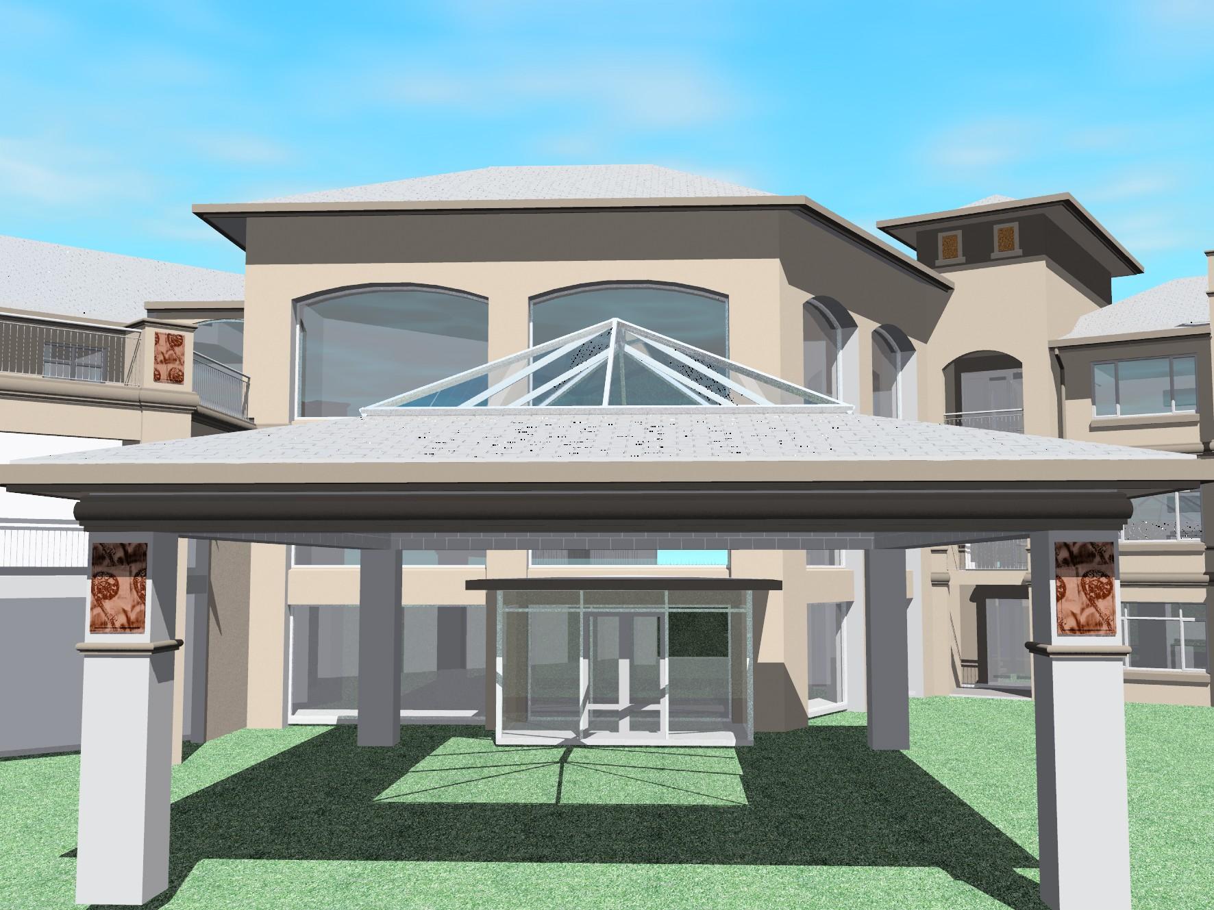

Can anyone help me with a problem concerning bitmaps applied to objects. Specifically can you get the bit map to always appea rcorrectly oriented. Studio Max does this with xyz coordinate system, does Revit have a similar function? I want my Koru to always be centered on the panel (see attached file). Cheers anyone who can help

I've never had the need to map something in Revit to an exact position like this so i'm not sure off the top of my head... I guess it would be easiest done using decals... This way you can set the exact size and location of the image manually and will be represented in shaded views with a crossed box so you can easily manipulate it. HTH.

Mr Spot is correct - use decals in this case. --------------------------------------------------------------------- Trying to use bitmaps on materials is not that easy... Revit is not like VIZ or Max... I have had some tryouts: http://revitcity.com/gallery.php?action=view&gallery_id=228 http://revitcity.com/gallery.php?action=view&gallery_id=227 And this one: http://revitcity.com/gallery.php?action=view&gallery_id=333
