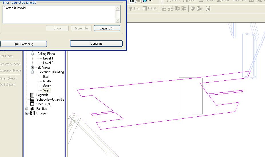

Hi! Can anybody explain me how can I make mass in compelx planes or just from weird profiles(pic. attached)?
-I open new project, take create mass, enter name of mass, import 3D DWG file, press Solid form, select work plane, sketch profile, AND WHEN I PRESS FINISH SKETCH IT SAYS "SKETCH IS INVALID" How can it be?
How can I make complex plane walls, foofs etc.?
Thanks in advance!

looks like very simple sketch to me....try to check again your sketch check for any overlapping line etc...

You must have either overlapping lines or one line in a diff plane or off the screen. You need a single closed polyline to complete the sketch, so somewhere there is a little line floating or hidden.  try swithching to thin line mode to see each line separately.  If you can't find it. quit the sketch and redraw it by tracing instead of picking lines.
