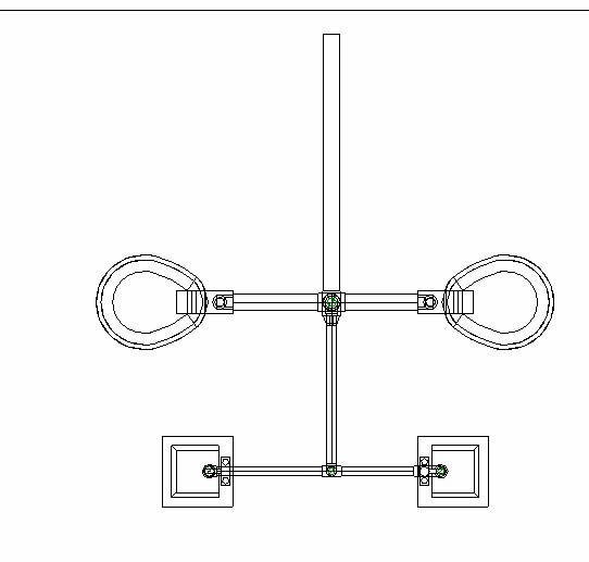

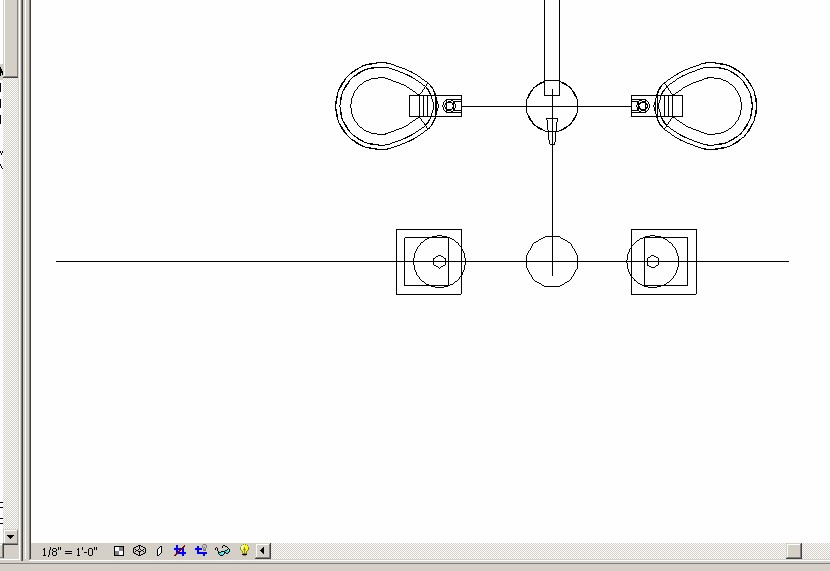

I am having some visibility issues with my p-traps. It shows up ok in the 3d view and in fine detail in plan view. But, when I change the detail level in plan view it shows up as a long line. I have tried opening the family and didn't see any lines that could be affected by visibility. if anyone has any ideas or has dealt with this issue, please let me know.
24703_p-trap-3d.jpg24703_p-trap-plan_view-fine_detail.jpg24703_p-trap-plan_view-medium_detail.jpg

I have found a couple of different solutions.
1- In the element properties dialog under Graphics I un-checked  the "use annotation scale" box. This causes the line to go away. But, it causes the trap to show up double line (like it would in fine detail).
 2- You can also right-click and hide the element in the view. This caused a little gap to be between the pipe and the fixture. But for permit/construction drawings this will probably be alright.
I still haven't been able to figure out what causes this line to show up. But, both of these will be decent alternatives for me. If anyone has any other ideas I would appreciate seeing them. Thanks.
