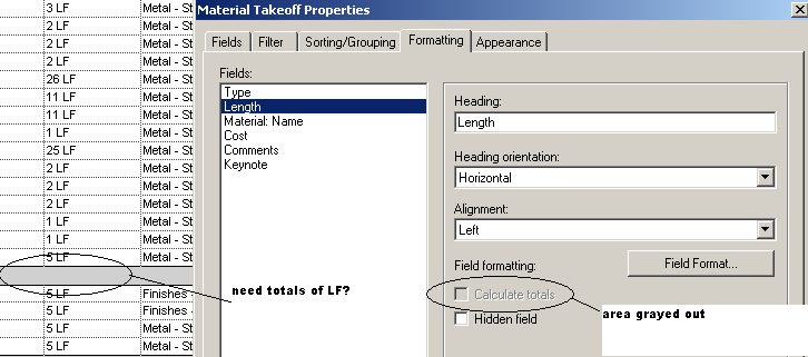

I've found I'm unable to get a total or grand total for linear feet in a material takeoff for walls!
anyone have a solution or work around?
If I go to formatting and select Length, Calculated totals is grayed out??
anyone Bueller, Bueller!
all responses greatly appreciated, if any!

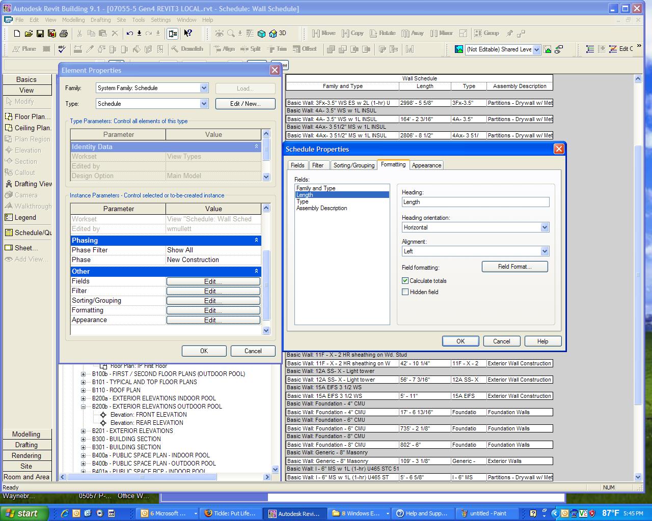

I have been very successful in schedule creation that delivers ready to bid information.  recent takeoffs from Revit were dead on!  There are many thoughts I could share... but to your main point of lineal ft calcs for walls.  each family of walls will have some distinctive difference... depending on your method of building a project up from inception to CD's.
Walls include foundations in our case... invisible walls and other non descript wall objects.  Generally we build 2x4 and 2x6 walls, sometimes arches that are variable sized.  So when you do run your schedule out and you are happy with it... you should only see the walls you want calculated for the takeoff or other function of the schedule.  We use project parameters and type and family param's to detail the schedules... then filter the information down to only the needed info....that said..
once your family objects are in the schedule, go to the formatting tab in the schedule properties.  select your field "length" and check the "calculate" checkbox.

the answer was calculated totals but as you can see I don't get that option.

the answer was calculate checkbox but as you can see I don't have that option here

I'm not sure where you are when I look at your images.  Your heading says material takeoff schedule.  How did you get there?
Set up your schedule and you should be able to get the results you need under schedule properties like what I've shown in the attached.
BTW I'm on 9.1

When I created a new one similar to yours it worked by creating a 'Schedule'. I originally created mine from 'Material Take-off' which caused the Length to not allow me to calculate totals.
lesson learned here
