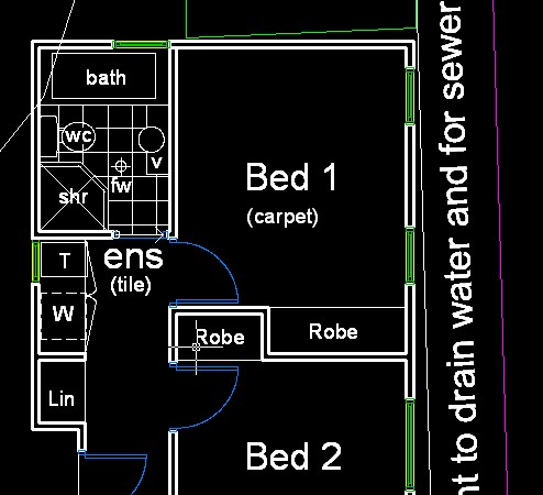

1 - With room tags are they there as a way to name rooms for room area calculations or as the actual text that will print on your final plan?  On my plans I will usually have the room name and then underneath it the general room size if presentation drawing or the floor finish if construction plans, e.g.:
 Living                  or       Bed 1
(3000x4000)                (carpet)

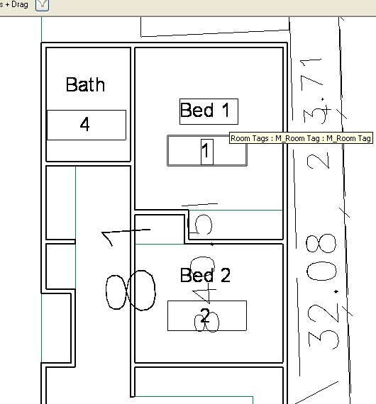

Do I do this with plain text or can I modify the room tag to contain what ever info I need?  I have attached some images showing what I normally do in ACAD and is what im trying to mimick in REVIT.
What is the correct method for achieving this?

Question 1 - You can have your room takes do whatever you want them to do - you just have to have a parameter to read associated with the room.   You can even place two or more different room tags in the same room!  Maybe one has the name / number and another has the floor/ceiling finish?  Have fun!

For the first and third questions.There is no way for Revits room tag to know the dimensions nor the floor material, that I know of.  You can make a Room Tag that has an instance parameter so you can change it to whatever you want.  Or...for the carpet one, you could create a Floor Tag with a instance parameter above where you can put the room name, it would recognize the carpet and that would be linked, but nothing else would be.

If your room has a parameter that shows the floor material, you can make a room tag that will show it..... Most of the time, we only schedule the floor material in the room finishes as a instance parameter which you fill out in the room properties.  Any parameter that you associate with the room can be included in a "room tag".  You just have to set it up.
I doubt that your AutoCAD tag figured out your (3000x4000) room size.  Same thing here - just add a room size parameter to your room definition and it too will schedule and or can be in a room tag.
