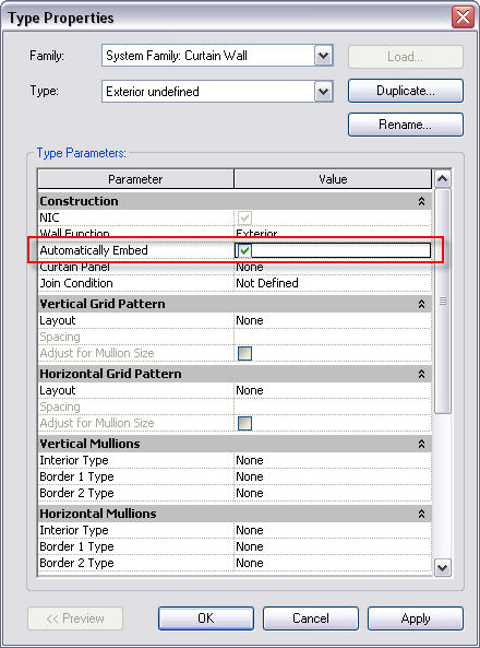

Curtain walls have a property that can be set so they automatically embed in the host wall.  See the attached image.

Wed, Jun 6, 2007 at 2:27:45 PM | Wall Style options?
mflure
Joined: Tue, Jul 25, 2006
33 Posts
AhhhhHaaaaa, Now Im understanding it.  Too bad there isnt a way just to complile a wall together so you'd just draw one wall and done, but I guess that would be in another version.
