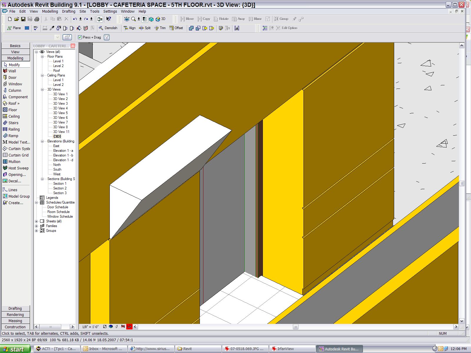

 I have attached a picture that shows my issue, i have placed my wall reveals on part of the wall and i am trying to get them to turn the corner, but it is not allowing me to place the reveal on the end.
the wall is a concrete wall with two layers of gyp bd.
How can this be done? I would appreciate
Thanks

Select the wall sweep, then in the options bar  you will see a choice for "change sweep return" select that than hit the edge of  your reveal, this will add a grip that you then can drag the reveal back to wrap into your opening.  For more complex conditions I recommend an inplace sweep that you sketch the path and cut out of the wall.

First, make sure that you wrap the exterifor of the wall finish at inserts[found under the type properties of the wall].
Next, click on one of the sweeps, on the options bar choose 'change sweep returns' click on the sweep and set the return angle to 90 or whatever you need. Then drag the blue grip of the return sweep and drag it to the end of your wall return.

thanks guys
