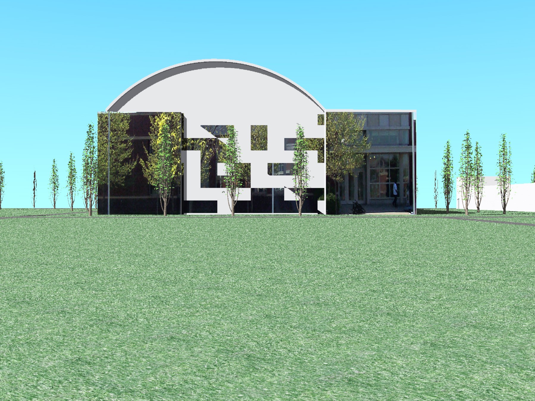

I have been having trouble with decals when rendering. Some decals show up fine and some have a "checkerboard" look to them. Below is an example. Any suggestions? tips? I am using Revit Building 9.1.

It looks like your decal is too close tot he wall.  Try bringing it away from the wall a smidge.  See if that works.
Let us know!  Good luck!

Hmm... You may find its the two accurender trees in front of the wall. Do a test rendering without them there and see if it still occurs.
