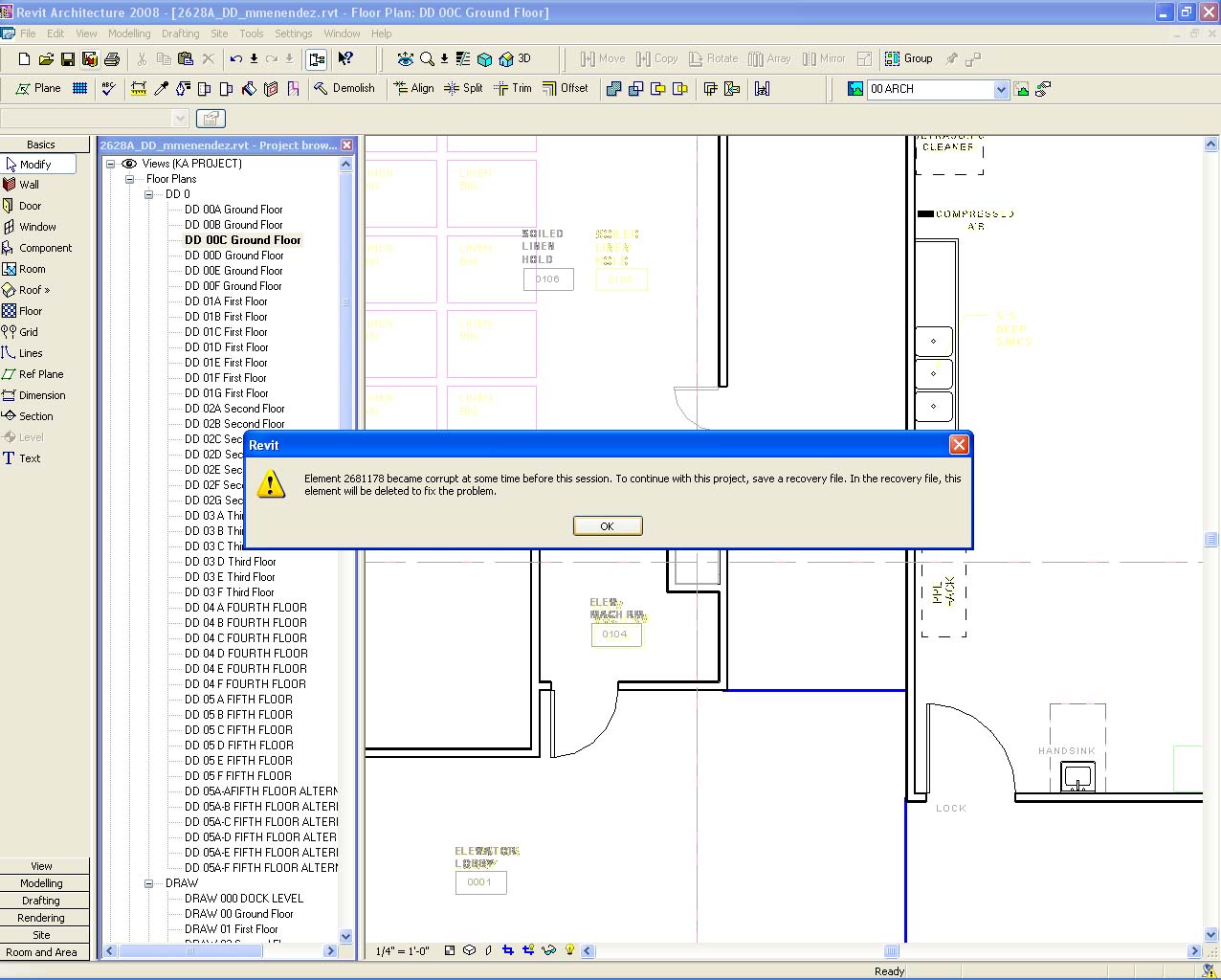

I keep encountering this message (attached) and cannot seem to figure out why this is happening. Any Ideas? Thanks in advance!

Try finding the corrupt element by going to Tools>Element ID>Select by ID then type in the ID number.  What it is may give you a clue.  It looks like you have ACAD files linked in and they are always a likely cause of trouble.
