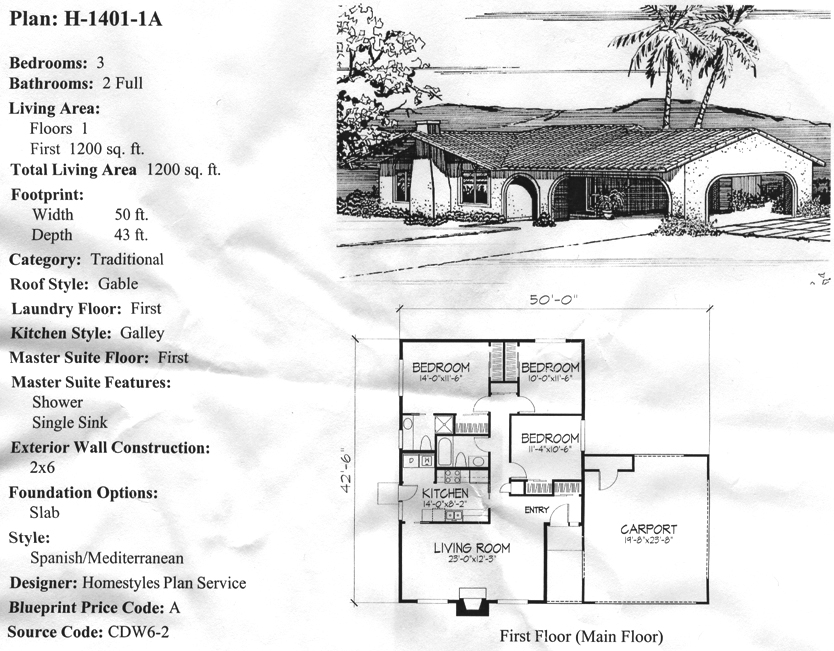

Hello, everyone! I've just started using Revit about 3 weeks ago and have already gone through tutorial on how to create the old, famous Gropius house. So, yes, I'm a newbie.
I am now trying to create a small Spanish/Mediterranean style ranch home that's about 1200 ft. I've already laid out the rooms and locked the dimensions, as well as added all the windows, doors, and roof.
My problems are as follows:
I'm not sure how to define stucco walls. Right now I have typical 6" walls for everything.
I also need to import a red, Spanish-style Villa tile roof, which is not part of the 9.1 library.
Last, I need a fireplace that extrudes as a chimeny to the outside of the home and tapers thinner toward the top.
I've attached a file of the floorplan and exterior to give you what I'm looking for. Hopefully, someone has already built this type of house in Revit and can steer me in the right direction.
Thanks,Tele Smile

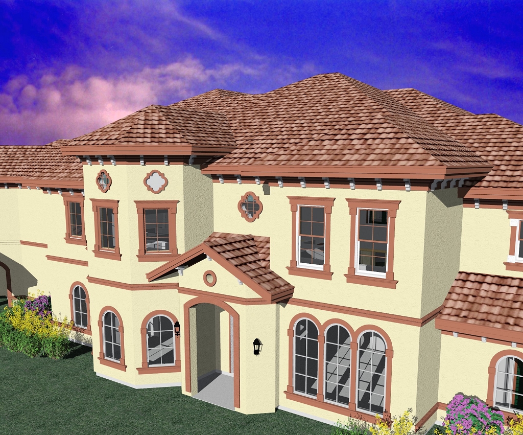

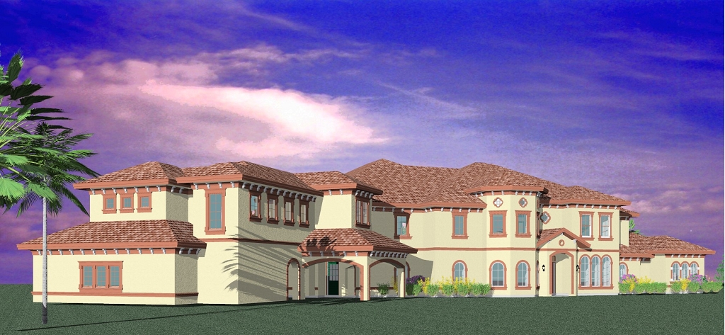

Here's one i did recently using OOTB revit materials. As for the tapered chimney, I've used the extrusion procedure as Telemakhos suggests and painted the surface(it was stone). The built in library is fairly well stocked.
