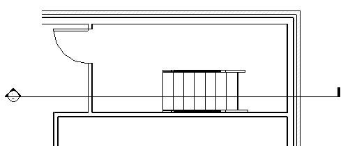

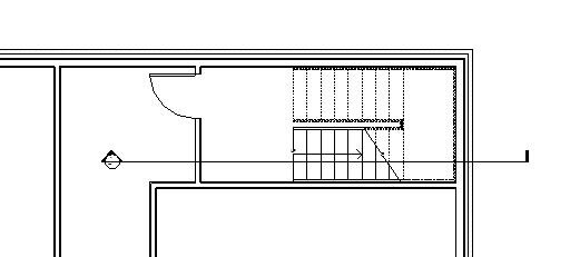

I'm curious as to what people have found as the best technique for creating stair plan enlargements.  I've found the appearance of stairs graphics in plan is different from those in enlargements created using detail callouts.   See attached images.  Can the graphics of the stair in detail callout view be changed to match those of the plan?  If so, please advise as I don't see how.  Are plan enlargments typically duplicate views with crop regions adjusted?

I have used both Callouts and Duplicating views. You can modify either to do the smae thing. It looks that in the image that is not showing part of the stairs, that you may have to change the view range in properties. Also have a look under stairs in visibility and make sure that Stairs beyond cut and Stringers beyond cut are ticked. All I can think of. Hope this helps.
