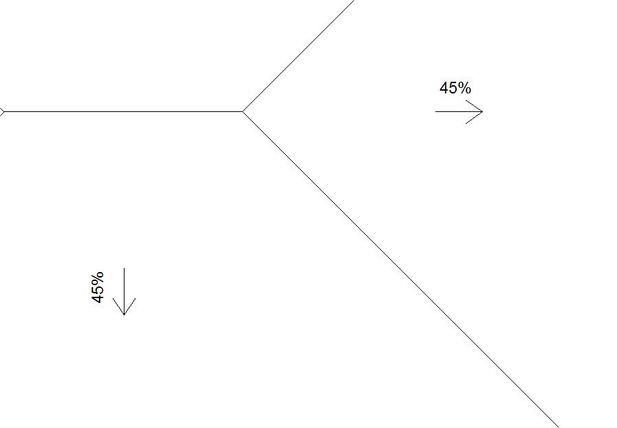

i'm interesting to put a tag in a Floor Plan-Roof, and to have an information about slope..only it
the best-in %
I would like it to be seen in this way.jpg, to be created automatically on every slope of my roof

I have tried to create a roof slope tag family to read the rise/12 roof parameter with no success.
RAC 2008 now has a 'Roof Tag' catagory but the available paremters you need to work with to calculate 'slope' notes are not available. There is also no Roof Tag annotation template file or sample roof tag family.
I also tried playing with shared parameters and a generic annotation tag family with no success.
Anyone else able to create a roof tag family that reads the roof system parameters to display roof slope / rise / run etc...?
