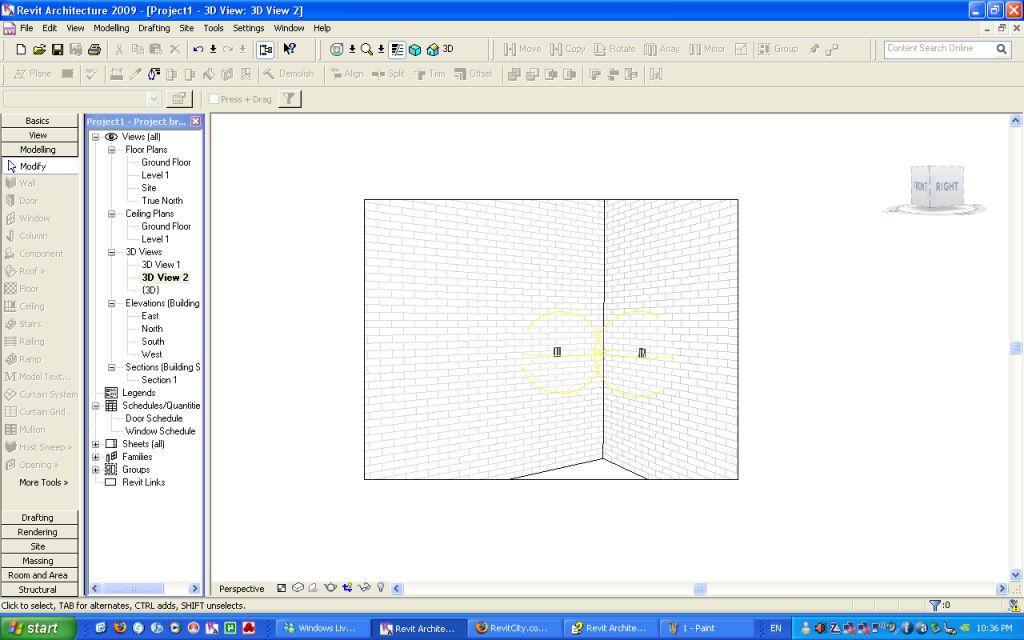

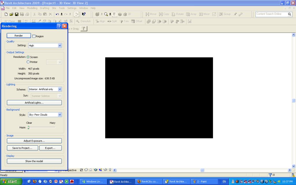

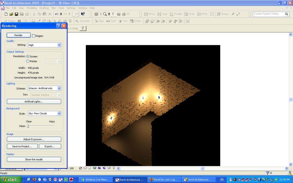

Hey, i created a light family, and when I render it in the generic 3D view (the one where you click the house in the toolbar) it produces light how I want it to, but when i create a specific 3D view just showing the light and the wall its on, the rendering just shows up black. Why is it doing this?? The picture is blurry because I stopped it, as I just needed to show the light is showing up. Im using RAC2009. Thanks in advance!

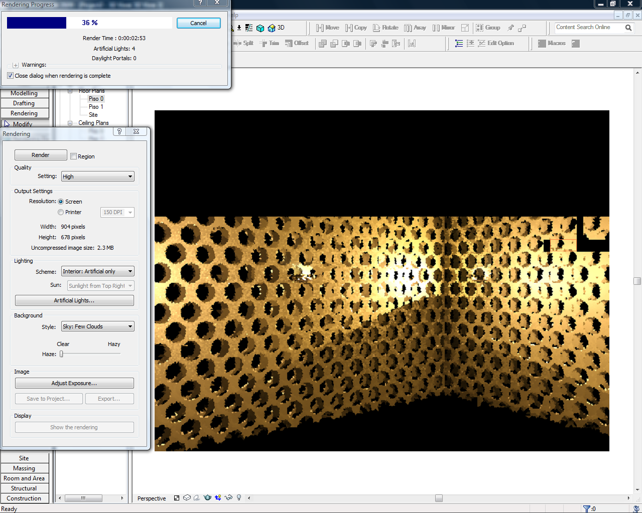

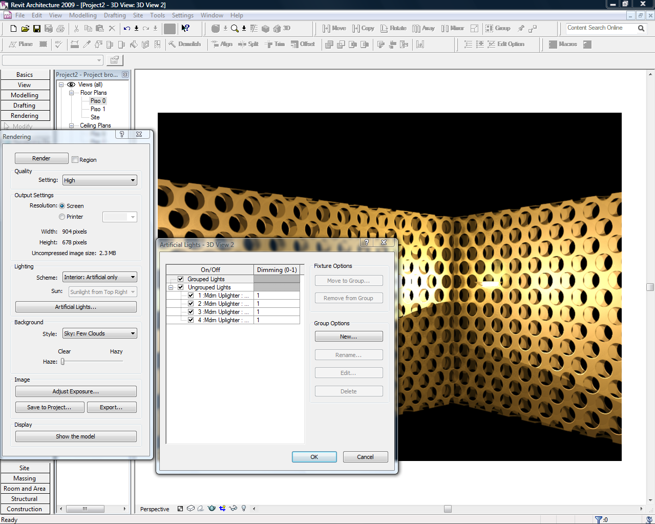

Hi, a made this simple model, and its ok, so TIMBO, i don't know, put here your model and i check what's wrong...
