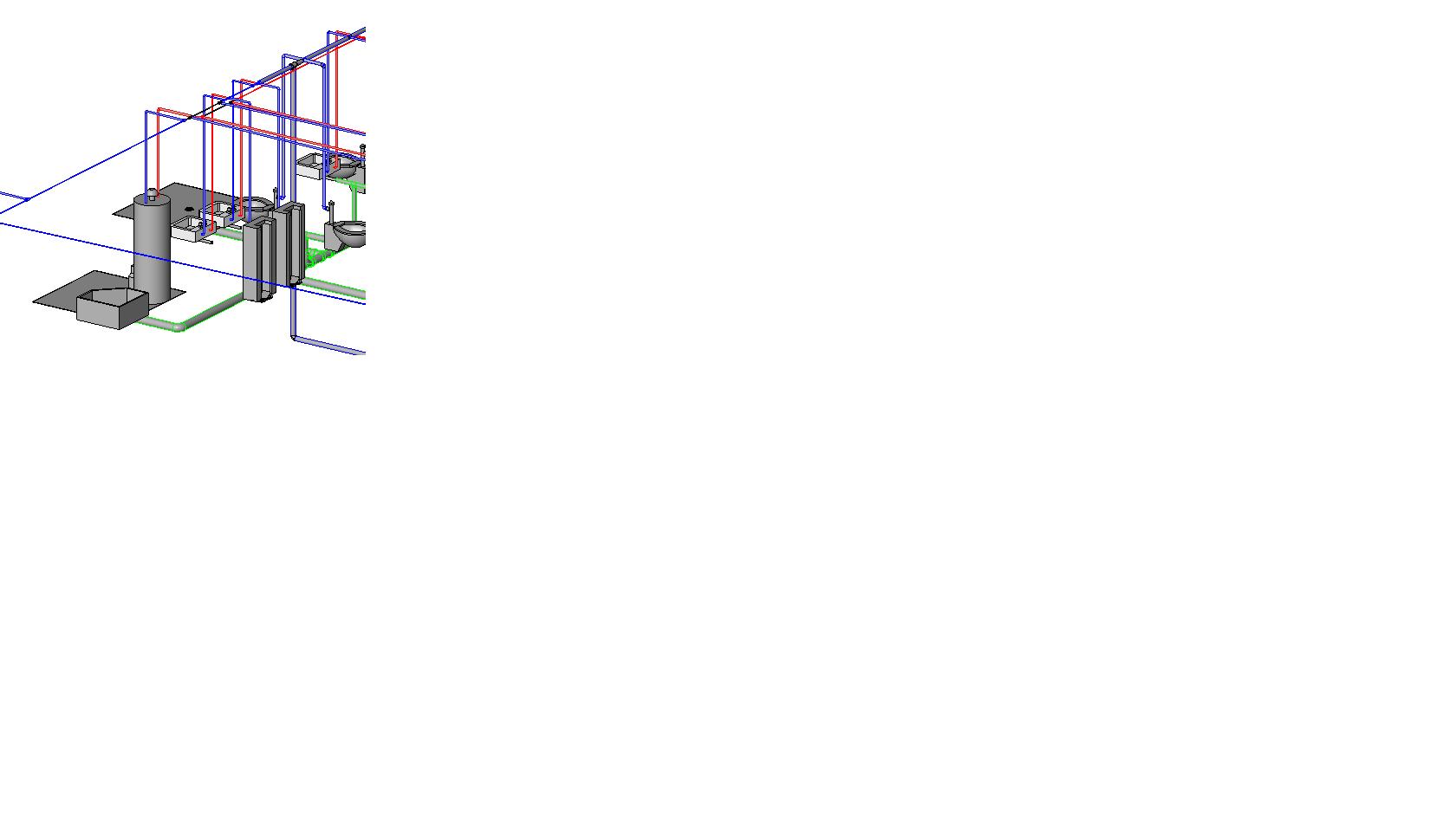

Has anyone had a chance to work with the plumbing in Revit MEP. I am curious about whether it is as improved as our dealer has promised. I would appreciate any reviews of it that anyone has. thanks

The plumbing is much better. You are now able to add connectors for HVAC, plumbing, and electrical. It still has a ways to go, however. P-traps do not even exist. Check out what I have been able to do.

A trap exists in MEP 2008
But, it is a pain to install. It can be done. I just figured it out last week. It does some real weird things on some fixtures. I would try to explain how I did it but, not sure I could. I have connected to floor drains and lavatories. Tried the urinals without success. I tried to attached the model but is was nearly 13MB. When I have some time I will recreate a small portion of the model and post it.

try see my plumbing sample, search it on downloads type "plumbing diagram" it was manually made on revitMEP2009
