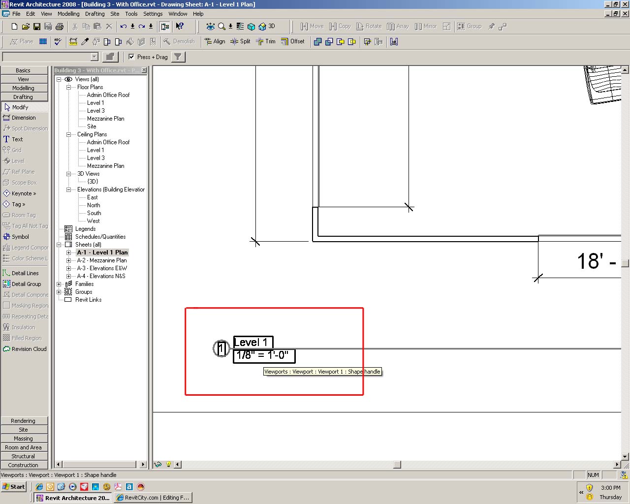

When I setup my sheets with elevations and plans they go in great but the problem I'm having is when I print them out the title below the plans or the elevations is way too small and isn't readable.  I've tried looking at its properties but it seems to be part of the sheet itself and won't let me edit it.  I need the font to be bigger and I need it to be a certain font.  Thanks for any and all help! =)

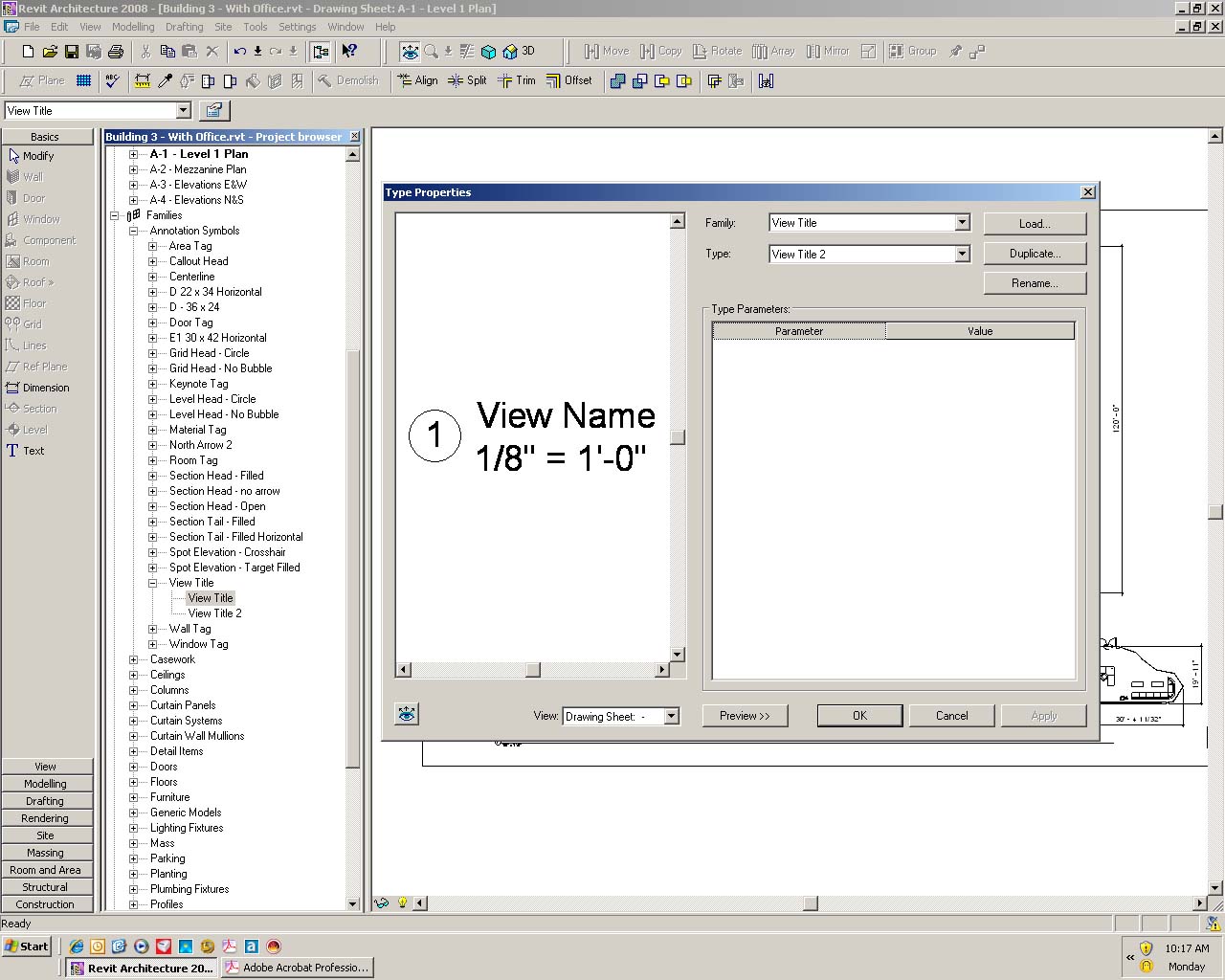

I did everything you said but once I got to view title the only thing under it was view title and it didn't have any properties or anything I  could edit.
What I'm talking about is what I've attached.  I hope this helps or works. =)

You're in the wrong spot... Smile
Your project browser on the left of screen...
Expand Families-->Annotation Symbols-->you'll have something in here called view title.
Edit that family and adjust font sizes etc as necessary and either save as new name or just load in and overwrite the one in your project.

Ok so I got this far... but now how to edit the family?  I know this is simple stuff... sorry I'm having trouble.

In your Component Library under annotation the view title it located there and you can then edit the family to appear how you would like.  Load it into you project.  In your sheet select the view click properties Edit/New.  Under Title select the view Title you just loaded.  Read the other options and see if you want those changed.  Click OK and you should be set.

Ok I finally got it!  I was right clicking the View Title after I pulled the main one down and it wouldn't let me edit them but when I right clicked on the main View Title before I pulled the view title menu down it allowed me to edit the family and load it after I made changes!  Thanks alot guys!
