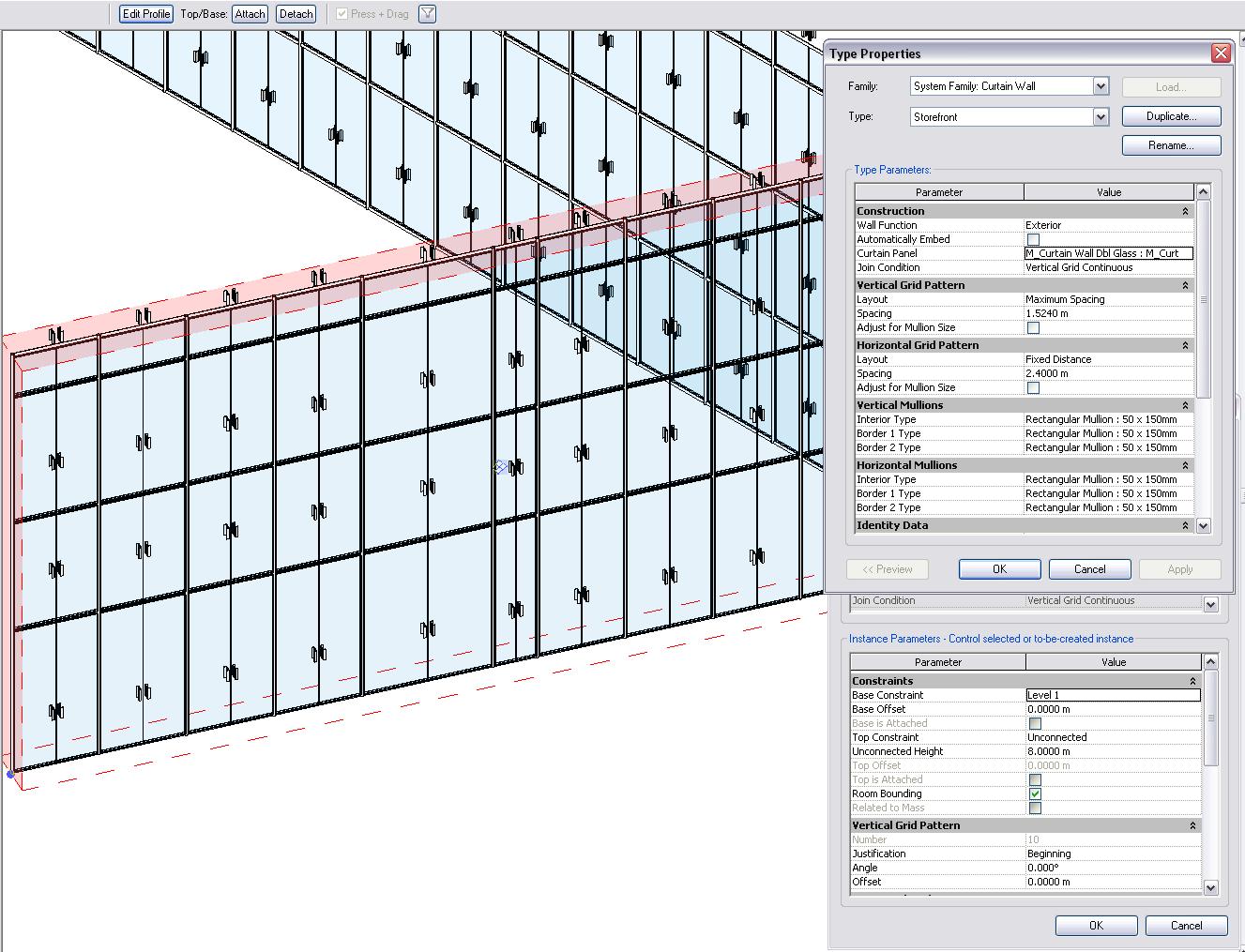

i think almost done but i cant place my glassed door in curtain wall. door is uploaded in my project already but how can put my door? what do you mean whit "Now in the element drop down menu where it says System Panel: Glazed, change the panel to the appropriate loaded curtain wall door family"  would you mind show me what "menu "is  with pictures ? :o)
Sat, Apr 21, 2007 at 7:29:02 PM | glassed door on curtain wall
leonardo1133
Joined: Sun, Apr 8, 2007
17 Posts
5 Stars: 2 Votes
mmmm after follow your instructions  finally get the  option but i select the door type and make all mullion in doors :oS , what can i do if i only want a dobble door in one space of mullion?
 check the image below

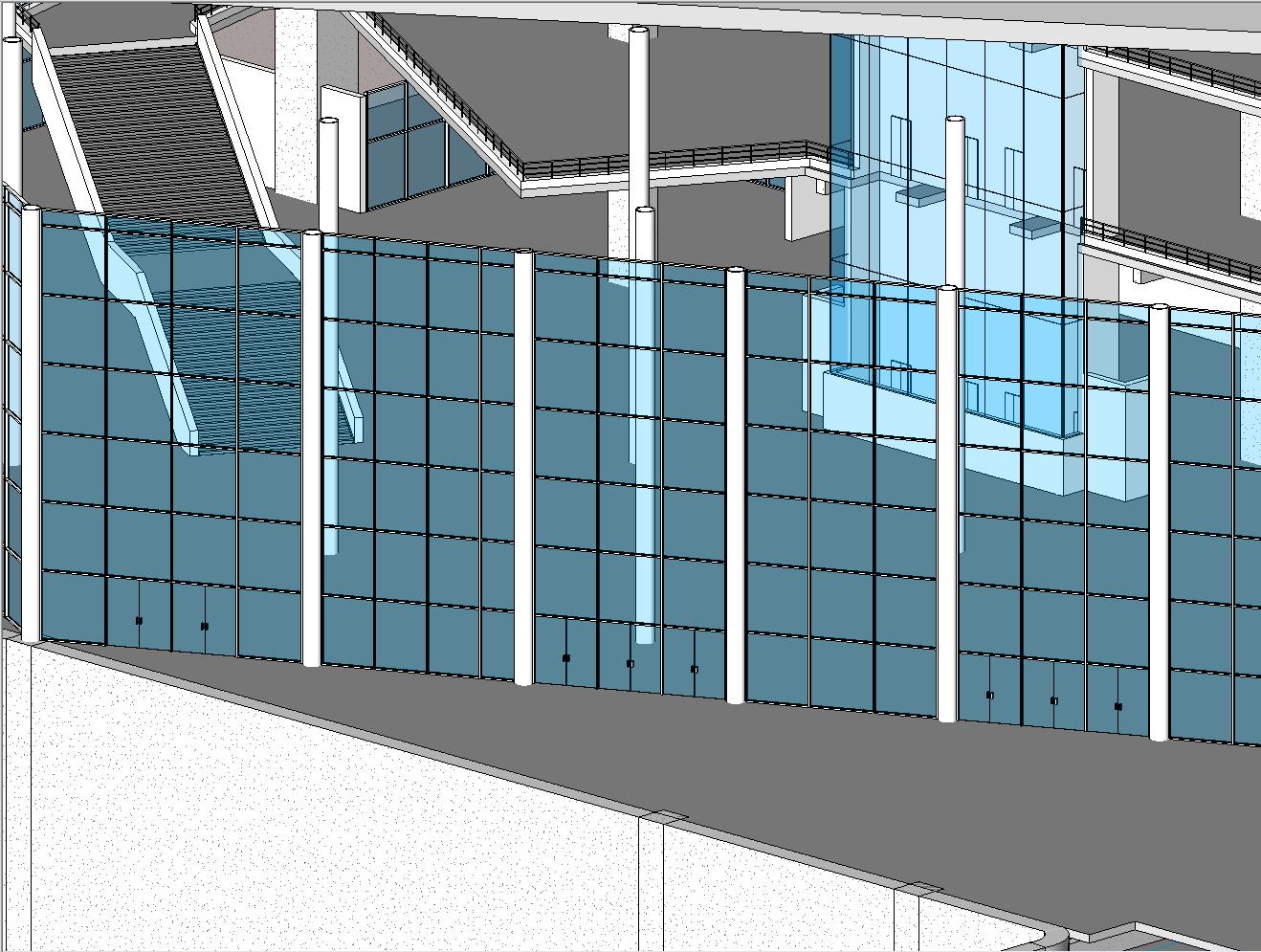

well.... im happy , finally can put  curtain wall glazed door. Thanks  to Mr. Spot and Coreedf or your support . here a picture below .
Curtain Wall Panel to Curtain Wall Door
