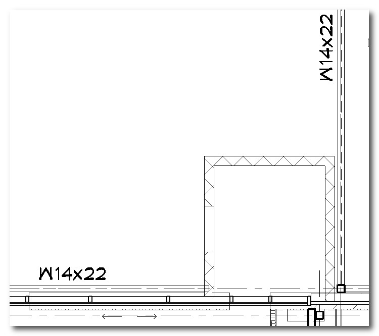

Revit Structure 4 and we're linking in the RVT file from the architect.

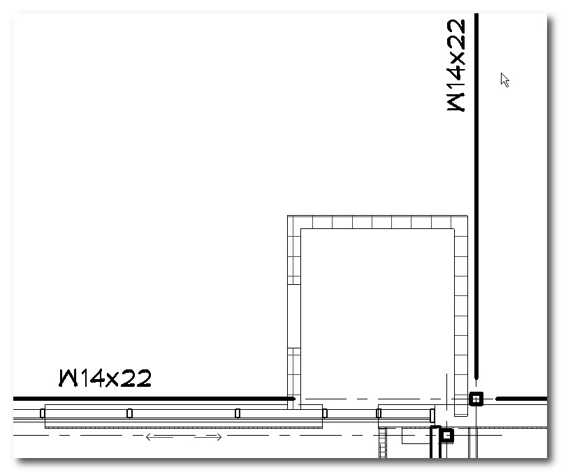

The issue is that the pattern for the cmu elevator shaft walls is not showing correctly when the detail level is set to coarse - it is rotated 45 degrees (see "_R_coarse.jpg" attached).  Then I change the detail level to medium and it is correct, but we all know that the beams are no longer single-line beams any longer (see "_R_medium.jpg"Winking.
The only difference in the two screenshots is changing the detail level.
Any ideas here?  Why would that change the orientation of the fill pattern?
Many thanks in advance.
Jeff

4.5 Stars: 25 Votes
There is likely a 'course scale fill pattern' applied to the wall type properties.  When the view resolution is changed to 'medium' then the course over-ride goes away and the materials 'cut' pattern show up.

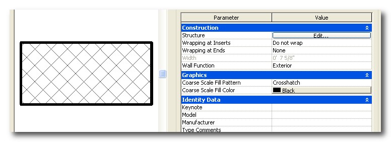

I checked the architect's RVT file and the "coarse scale fill pattern" is crosshatch at 45 degrees Cryingsee the attachment), so it should show up correct, right?  I've been playing with a number of things, but can't seem to get it to show correctly.

OK - problem solved.  The architect had the Coarse Scale Fill Pattern set to just "crosshatch" instead of "diagonal crosshatch."  I know that I said I had checked this earlier, and I did.  In the 3rd posting in this thread, I even attached a screenshot of the setting and the preview from Revit.  Well, the preview showed it as diagonal, but that preview is not for the Coarse Scale Fill Pattern - it represents the regular fill pattern(s).  I changed it to "diagonal crosshatch" in the arch rvt file, saved it, reloaded it, and all is now how it should be.
A valuable lesson learned about the Coarse Scale Fill Pattern: pay close attention to what the pattern says, not what the preview (that is right next to it) is showing.
