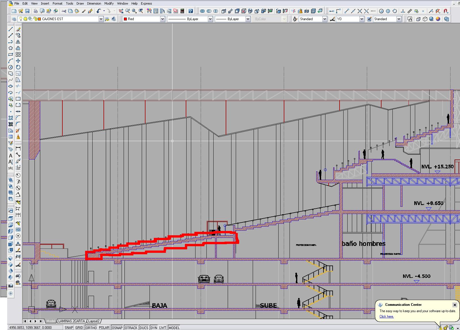

Hi everyone, in this days i`m making a theater . everything was going ok but... the slab for the seats ??!! how can i model that? any commentary.. plz , need help :oD

yes of course, i am adding a section view from Autocad for reference. thx! in floor plan the gradins are in arc form.

5 Stars: 2 Votes
Sure , im adding a section view. thanx for your help! :oD

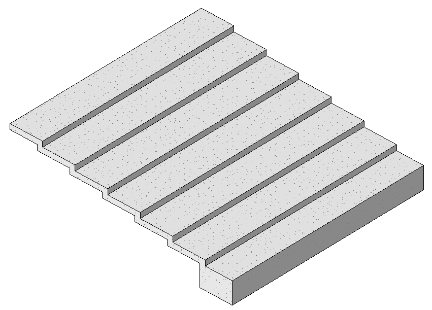

you could create an in-place floor family and just model it. not quite parametric, but it works well.

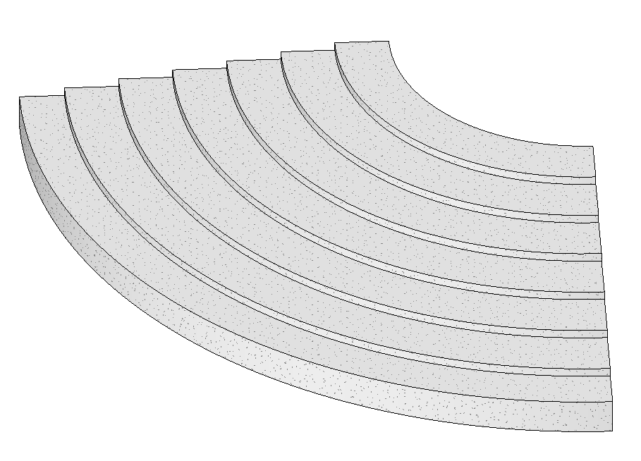

sorry, i forgot it was supposed to be an arc form, same principle though, just use a sweep. model the arc and sweep the stair profile along it.

 OK!!! that what i was looking for! in my first try i did with stair with boundary arc but the results wasnt well. mmm would you mind tell me step by step how did you got that arc slab, plz :o).
 i'm a expert with Autocad an d i`m trying to emigrate to Revit and many things are difficult to understand the Revit plataform. :oP
Thanks for your help and support JTERRELL!

look at this pdf file

THANK YOU VERY MUCH JTERRELL!!!!! AMAZING  TUTORIAL!  :OD
