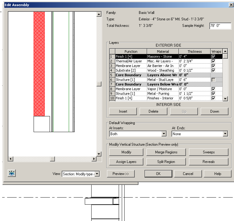

I have recently looked into the modify commands within the wall structure. I have done something to my wall and one, don't know what I did, 2nd I don't know how to fix it.
The only command I actually used on this way was the modify where I unlocked my exterior material and moved it down. As you can see now I have a void in my and not sure how it got there.
attached is an image
thanks

That looks like a wall sweep or reveal to me.
In the same view that youve posted, have a look under the "Reveal" and "Sweep" buttons wether something has slipped in (just delete the instance in the table if you dont want anyting there)
