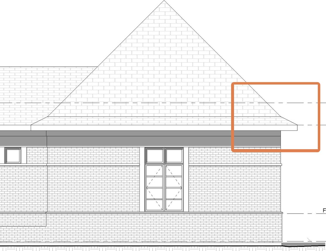

I am wanting to achieve a roof that starts with a 6:12 pitch and then goes to a 12:12 pitch (ref image).  I have created the roof by using two seperate sketches as you see in the attached image.  Is there a way to do this in a single sketch?  I want the line where the two meet to go away, and the shingle pattern to just carry up the roof.  This is a common design/ construction detail in French "style" homes.  Any thoughts on how to achieve this.  Thanks

Try joining the roofs with the join roof command or join geometry.  If the suface pattern is model based, use the align command to align the shingle pattern.

Another way you might be able to get rid of it is using the linework tool and using invisible lines.
