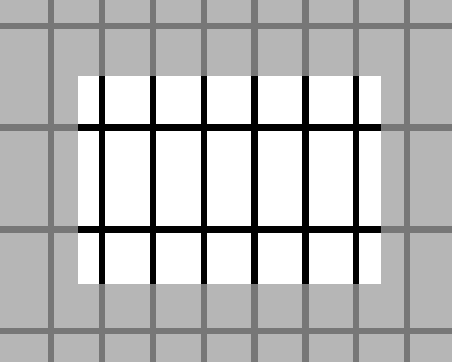

Never paid a lot of attention to Revit's initial orientation, but Hogmodo seems to be correct in that it adjusts to the overall orientation of the room it goes in. It makes sense that it would try to do this when you think about it because an angled room gets an angled pattern by default.
 I'm still learning hatch pattern editting, but I was thinking that a custom pattern that is oriented 90 degrees to the tile lines and that centers on a tile might work in this situation. Since it would take me much too long to test my theory, I thought I'd throw it out for testing by people much more adept at hatch pattern creation than myself. The image I have attached illustrates what I was thinking, but assumes that custom hatch patterns (and not the lines within them) are the Revit default center. If not, maybe this just fixes the 90 degree question. Just throwing it out there.
