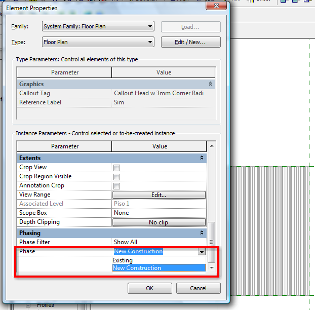

This is an old post, but I was having the same problem, turned out I needed to move the Primary range bottom up higher.
Sat, Nov 8, 2008 at 11:57:34 AM | Underlay won't show up??
Joined: Tue, May 22, 2007
5921 Posts
4 Stars: 205 Votes

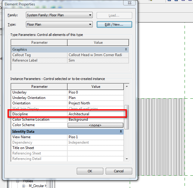

Hi, did you check "Discipline" and "Phase"???
