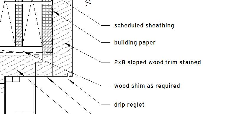

running version 9.1; when i keynote items, the leaders snap to other existing leaders, but i cant figure a way for the first letter of each keynote to align.  Cryingvertically)  and for the leader to end in a particular spot.  see photo; as far as i can figure its coincidence that the bottom two align the way they do and coincidence the top two align the way they do. id like to be able to pick one or the other.
The list of notes looks quite messy; has anyone figured out how to align the text?

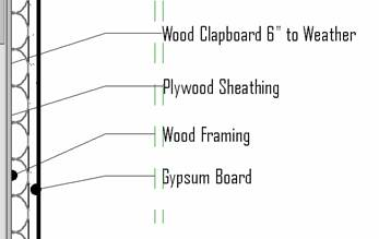

hopefully you've figured this out by now...but if not.
I'm running RAC 2008, but I hope it's the same. When I annotate something with leaders I chose the leader option that allows me to place the elbow (two segments.) I then set the start point, the elbow point and then the length to the end of the leader line, then the text (either left or right justified.) Then each additional leader will align to both the elbow point and the end of the leader point.

i understand how that tect alignment works, my problem that i have run into again is when i am annotating a detail, i am using a mixture of text  and keynote tags. i cannot get the edges of a text note and a keynote tag to align. any ideas??
