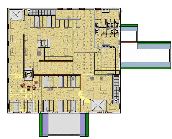

When I look at the 2nd floor all of the lights on the 1st floor show through in half-tone. How do I view the 2nd floor without seeing what is below it?
Fri, Mar 30, 2007 at 10:39:22 AM | View range
natejohn
Joined: Fri, Jan 12, 2007
2 Posts
right click on the screen away from your building. Go to view properties. Find underlay in Graphics, and set it to none.
I hope this helps.
Fri, Mar 30, 2007 at 11:01:39 AM | View range
JimIII
Joined: Fri, Sep 15, 2006
18 Posts
Thanks, it works perfect.
