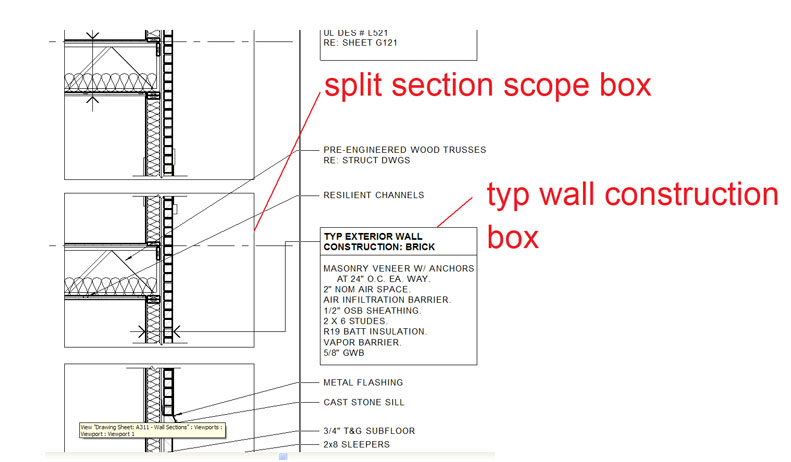

any feedback on which way is better?? I'm working on wall sections and am looking for feedback on what is the best practice.  This is my firms first revit project.

Place your notes in the view, never on the sheet.

If your notes refer to multiple views on multiple sheets you can create them in a legend. Then place these on multiple sheets, really handy if they refer to more than one view, also saves you time if you need to edit them.

It was my first instinct to place notes in the view as well but what do you do when you have instances where you would like to draw outside of a scope box? (see attached image)
We place a box around our typ wall assembly description which you cannot do in the view if you are outside the scope box.
Any suggestions or thoughts?

you really should be using a wall tag for that information; ie WA-2 (or whatever) for wall assembly 2, referenced to its general information somewhere in the front of the set.
