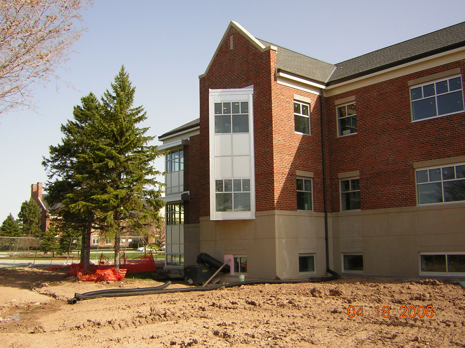

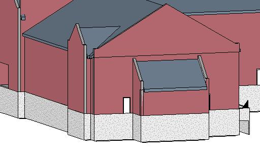

I have attached a sample image of what the problem is.  I am creating some architectural end gables to match an existing building.  I have also attached a photo of an example of the condition I am trying to re-create for my new addition.
In the image taken from the Revit model, I built a new wall on top of a lower wall so I could modify the profile.  In the small bump out below, I tried modifying the profile of the wall instead - it works for the right side end gable but not the left side.  In plan view, the corners do not wrap well.  The wall type is a brick on cmu cavity wall.

hehe, I meant the other stuff about the roof. I got the gable part. What I did was create just a quick gable profile somewhat like you have. Take a look and see if it matches what you got there. You might just be better off deleting the wall or roof in question and redraw it.

Yes, this is pretty much what I am trying to do.  Your walls in plan wrap at the corners, but mine don't.
Did you draw the wall with the gable end first, and then modify the profile before you drew the other walls?
