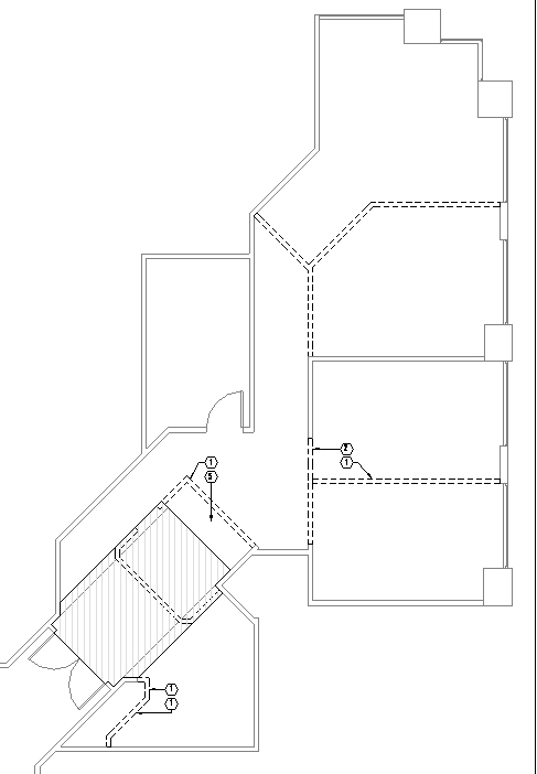

I'm trying to create a Demolition Plan using our firm's standards but I'm having a bit of trouble.
I can't get the doors and door swings to show up when the Demo filter is applied. All it shows are dashed lines, for the demo'd walls.  (See attached photo)
Any idea how to get the doors AND door swings to show up. Ideally, I would want them to be dashed lines...just like the demo'd walls.
Any help would be great! THANKS!

Make sure that you have the phase setting correct. It sounds like you have the doors on the wrong phase or the view on the wrong phase. View phase should be new , doors and walls to be removed should be on existing.
